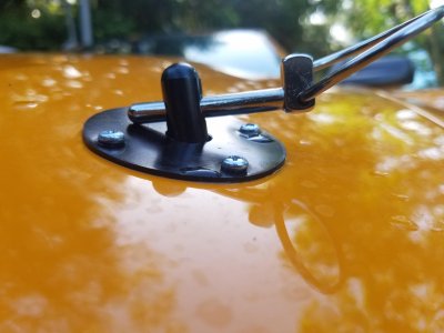

+1 on rotate the post with the hole so the two sides are parallel to the hood surface. Had to do that on my steeda hood, to adjust the posts and line up the holes so the pins go in at an angle.
this may help:
