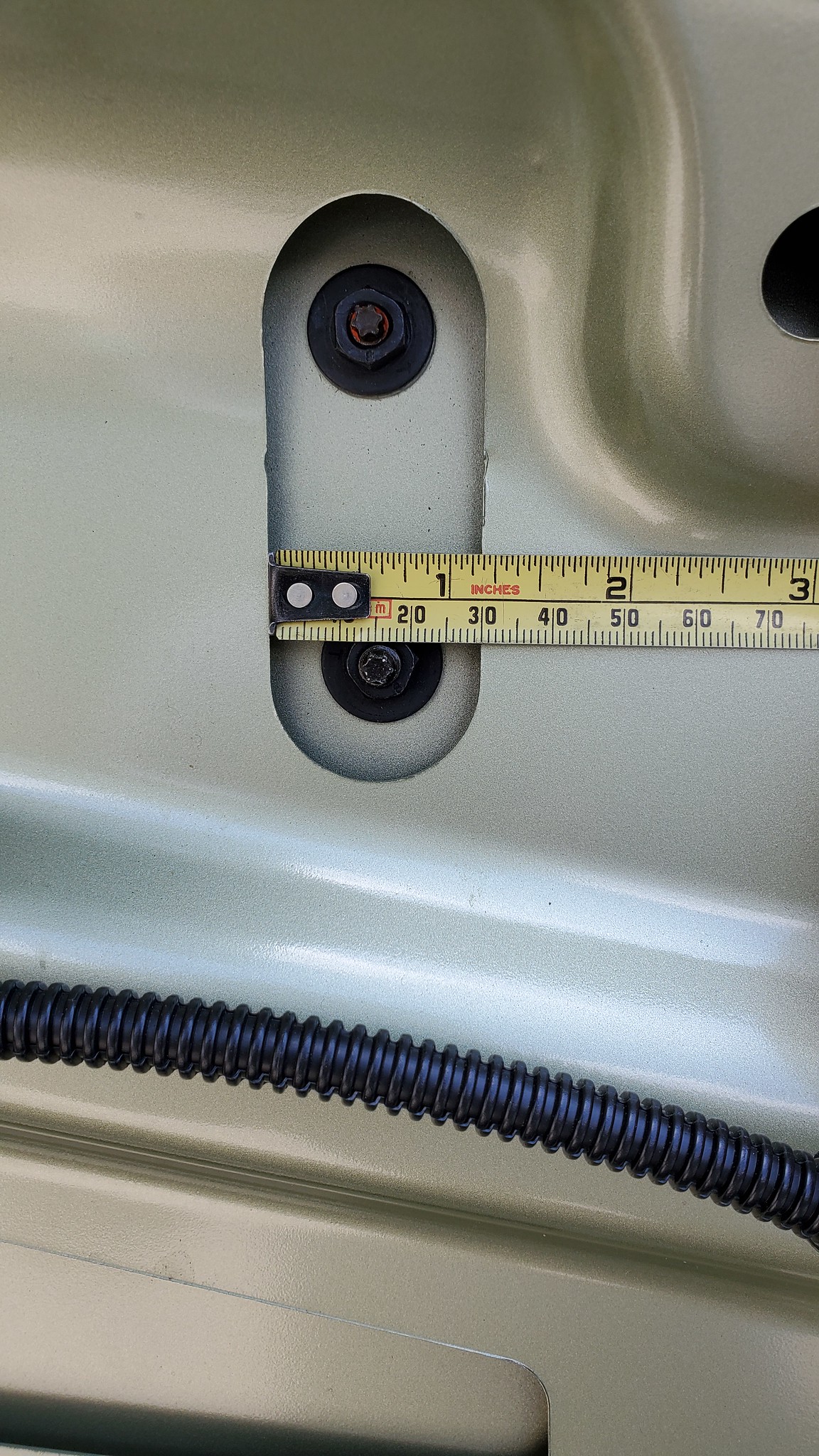

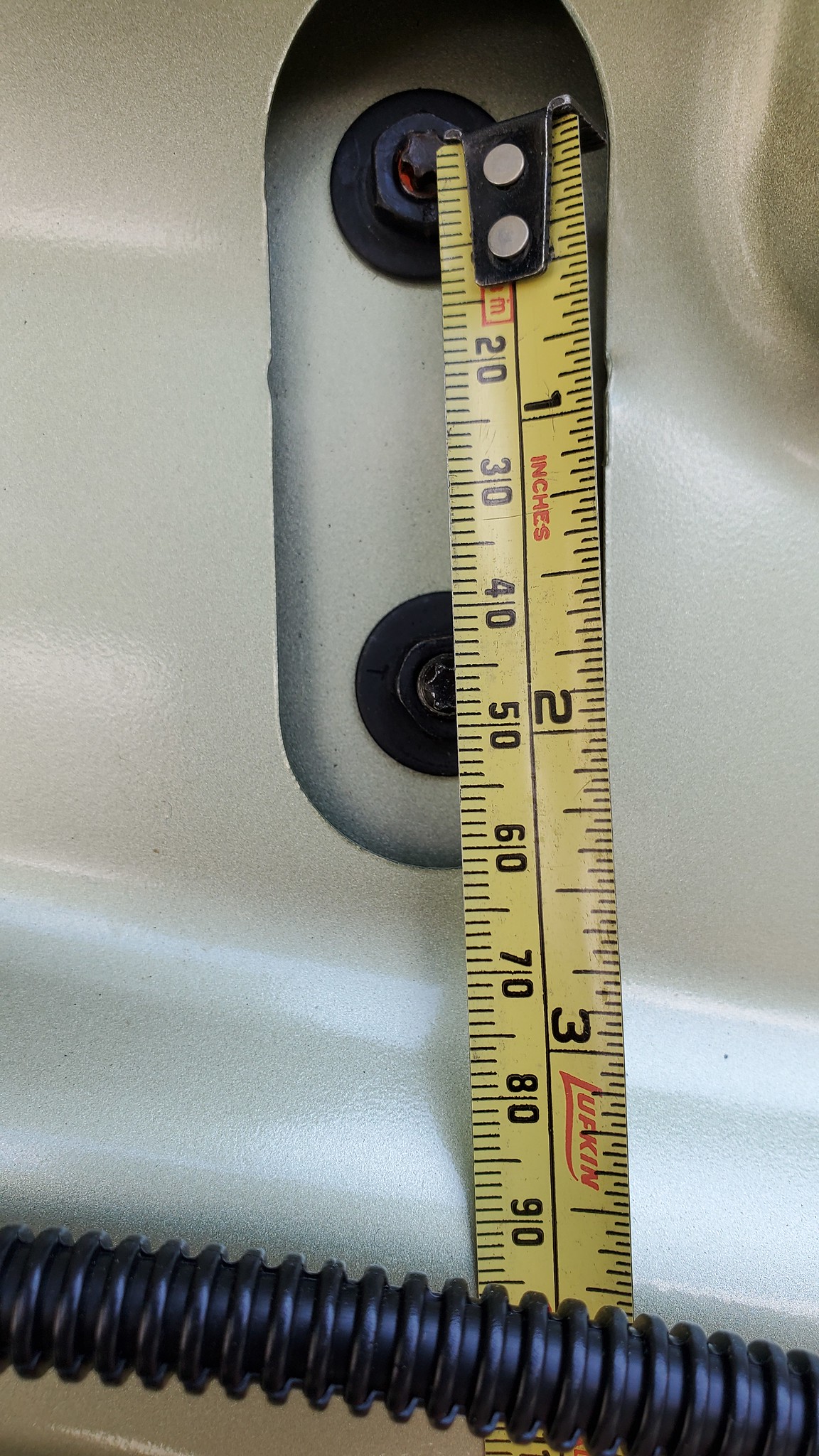

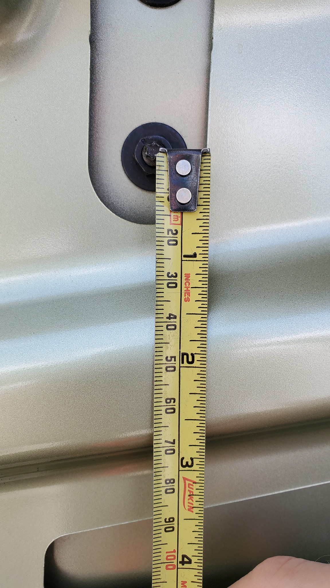

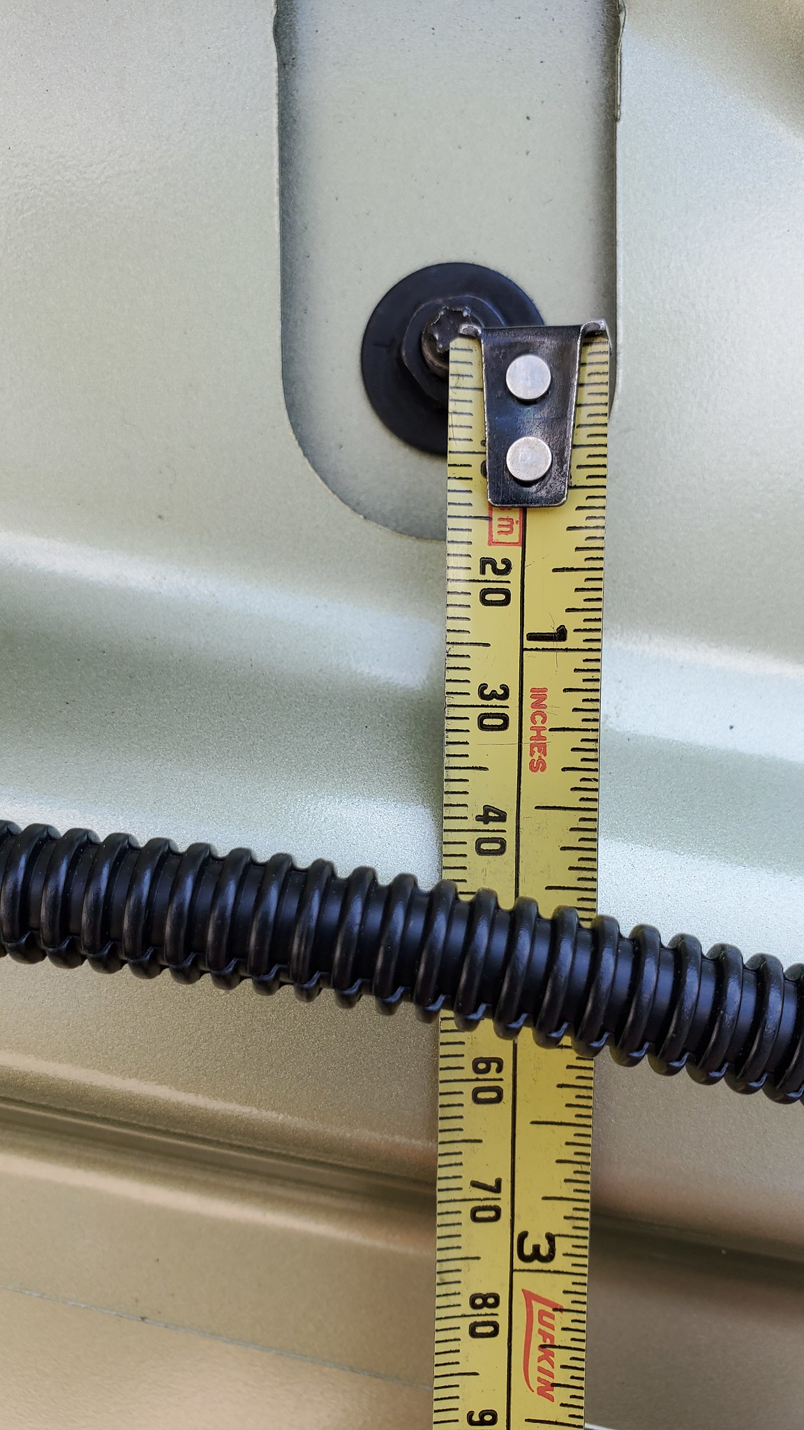

My guess is the holes are oversize to allow the spoiler to be adjsuted left to right a little bit and account for manufacturing differences in the spoilers.
Right side of trunk lid, stud is 15.5mm from left of opening to center
Left side of trunk lid, stud is 16.5mm from left of opening to center
Both right & left side are 17mm up from bottom of opening to center of stud
Studs are 47mm center to center
