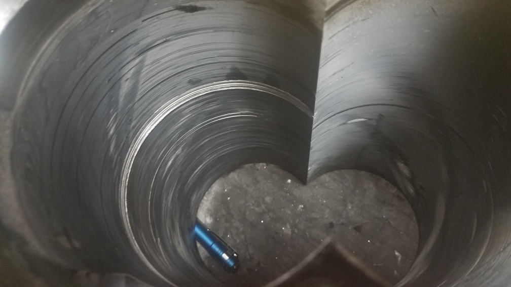

I spoke with Mike on multiple different occasions about the blower and some other things. I ended up getting a kit that had some holes that weren't tapped, missing parts in the instructions, ya know small stuff. Nothing that was a big concern. Mike has been a great communicator and even sent me the smaller 3.5 pulley and pulley wrench at no cost. This goes without saying, when I send the blower in, I'm sending the pulley along with it. I did torque everything to spec like the instructions said as well...no foreign object injestion whatsoever. I gave maybe 8 or 10 miles on it. First log was just a start up log then driving very light then a small pull in 3rd gear up to 4500. Then got the new 3.5 pulley did the same logs again and did a pull to 5000. Then did a pull today, didnt even get to 4000 rpm and it seized..oil level was checked very meticulously on both the engine and blower. Same for coolant. Never ran lean never ran hot, etc.
Sent from my SM-N950U1 using Tapatalk
1950StangJump$
Apr 1, 2010
966
108
It sure does look like something got sucked up into the rotors.
Or the "seizing" caused stuff to break and get run through there.
But, those blades have obviously seen some stuff.

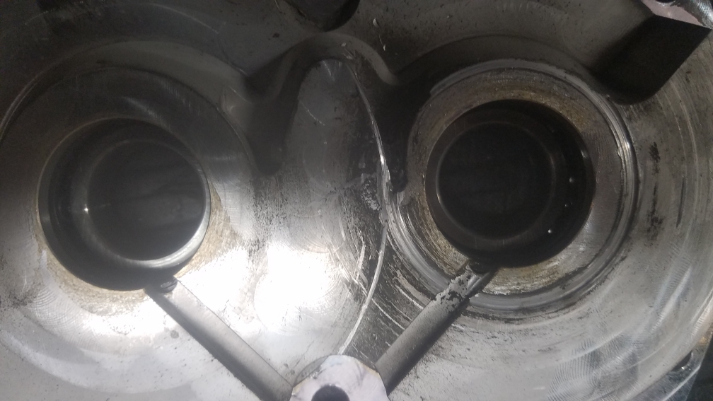

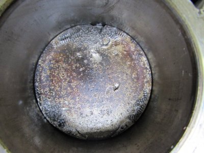

I very against the whole foreign object deal as a possibility because I've done 4 datalogs, 4 pulls and regular driving logs before that pull that seized it..if something was in there it would have done it the first pull or even the second.. I found nothing missing from my throttle body also. Checked down underneath the manifold and saw no signs of damage and on top of that, the bypass valve had no damage either while h is the most likely source of where material would get into the engine. Regardless I am going to scope it and check.
teeje
Mar 7, 2017
563
102
Ohio
I scoped every cylinder and they all look the same
Maybe some very small shiny particles but the camera is black and white. Could be reflection from carbon but I saw absolutely no damage

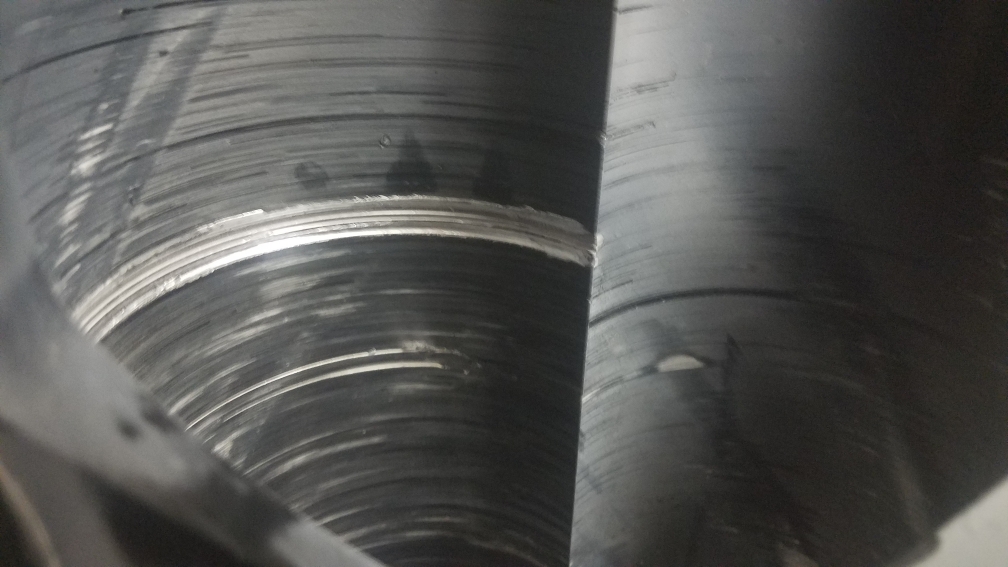

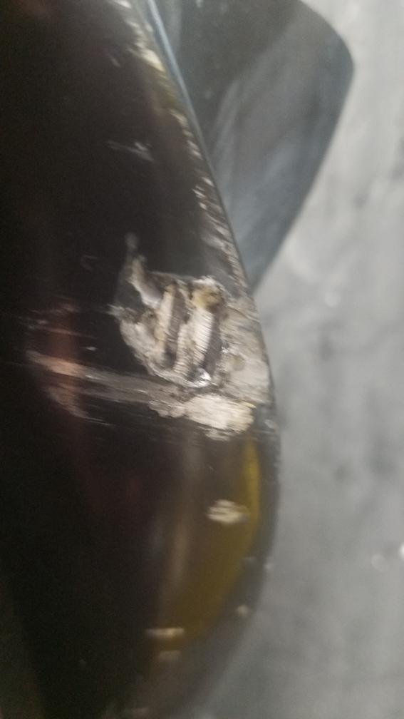

Man. Let me tell you what. I am one LUCKY SOB. I bore scoped the cylinders saw no damage. Maybe a few specks of aluminum but no damage. Took the manifold off and took the back cover off, nothing made it through the intercooler. Scoped the valves no damage. Just small specks of aluminum. Kennebell got my blower Monday and sent me pictures of the damage. I'll attach some pictures below. Somehow a small aluminum screw got into the blower. They said they were going to figure something out for me. Mike said he doesn't believe in making money off of misery which made me happy. So I figured they were going to take some old parts and rebuild me another one. Well Carlos called me the next day and said Mike and Jodi were on board for this deal and I asked what it was. They said they have a brand new blower thats never been mounted but it had a few tiny scuffs on it and that they will send it to me at no charge just pay shipping..boy..am I glad..and lucky....I ordered my kit April 5th and got it I think early July. Apparently I was one, if not the nicest person they spoke with regarding my order. Everyone else was an asshole apparently. Guess it works out to be patient and understanding.
Edit: pictures attached
