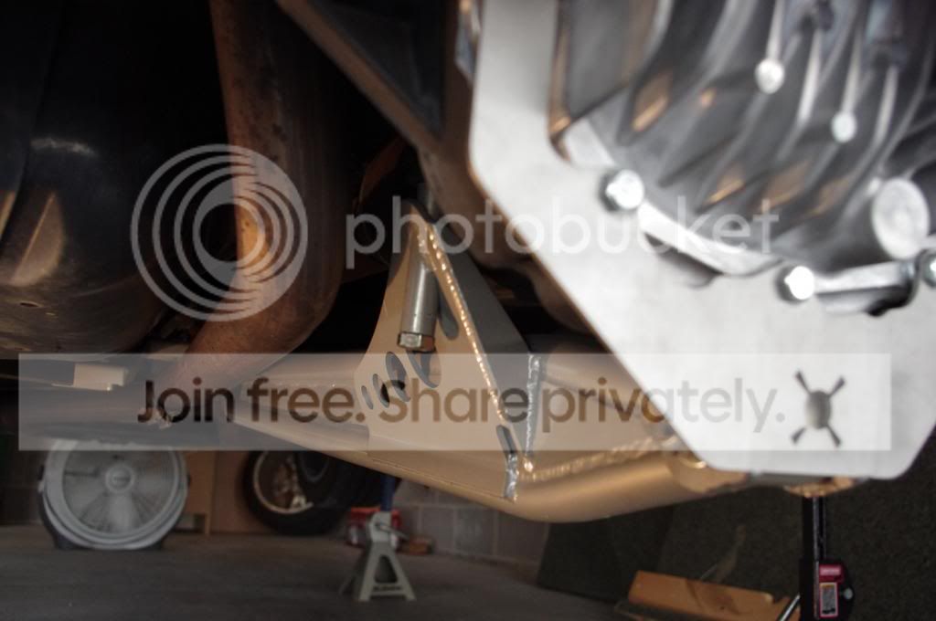

Rigidly mounts to the axle and is constrained in the vertical and side to side direction at the chassis mounting point (it can "plunge" fore/aft with the arc the LCA's create). Eliminates axle windup entirely and uses that force to plant the tires. IC location is very stable compared to a 3 link setup which has it's pro's and con's.
This allows me higher %Anti-squat without dicking with LCA relocation brackets or the UCA since a Torque Arm replaces the UCA. Less NVH than an aftermarket UCA with sphericals (which is what I would use because Corner Carver) with higher degree of roll freedom than an UCA with Poly bushings at both ends.

Good advice folks. And thanks for the photo W11...
