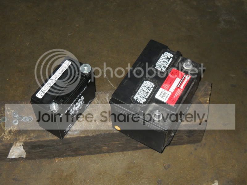

Here is just a comparison between the two battery sizes.

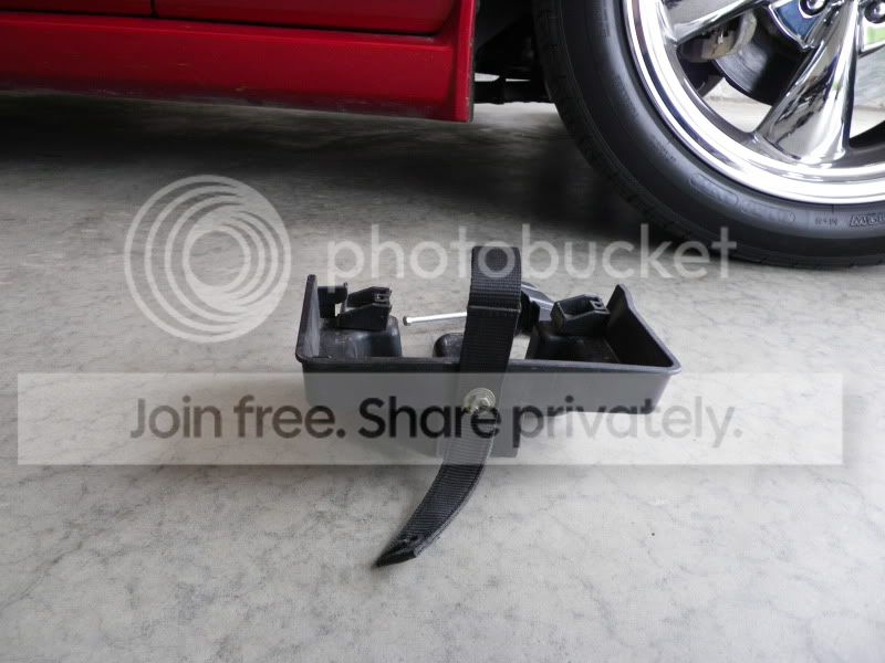

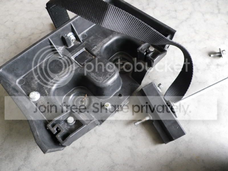

First thing we did was cut the battery tray off to where it would fit the new battery.

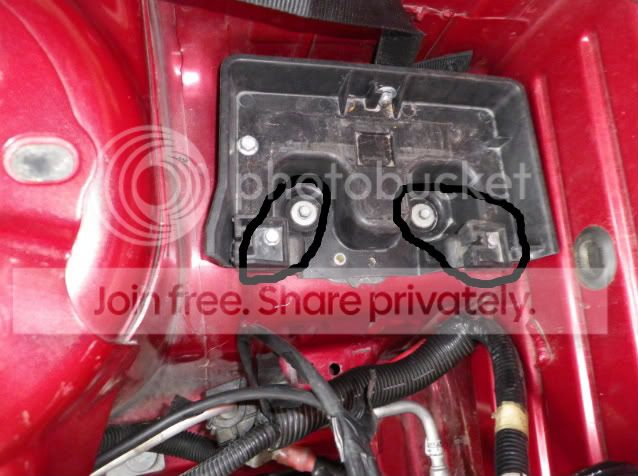

I circled the bolts so you could see I was able to keep them in the factory spot so it screws back in normally. We were lucky to still be able to use the little battery stops in the same spot as well and hold the Yuasa in there a little better.

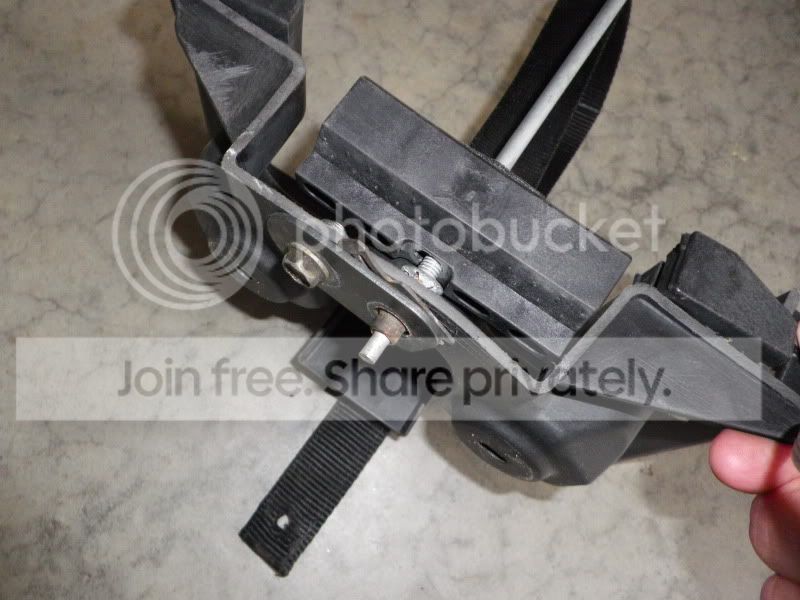

After cutting the tray, we drilled new holes in the tray for the strap and where the bolt screws in to tighten the strap down as you will see in the next three pics

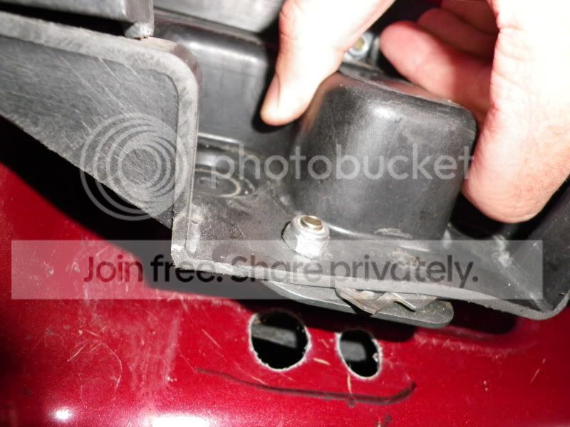

We had to drill two holes in the car so the tray would sit ok.

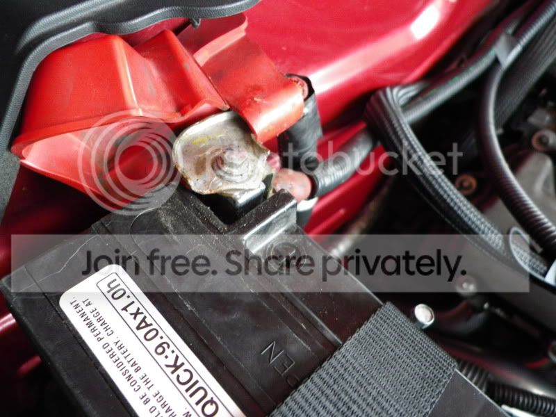

Next thing we did was cut the battery terminals and drilled a hole in each terminal for a bolt and washer to screw into the Yuasa battery terminals

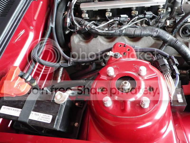

Here are a couple pics after finished and the battery being hooked up.
^^^Havent cleaned up all the extra wiring since I put the 2-step on so it kinda looks like a mess right now. If you need to get to your headers for any reason this makes it a ton easier now that you dont have to take the battery and tray out. Also, it may help extract a little heat and not have everything so cluttered up underneath the hood.

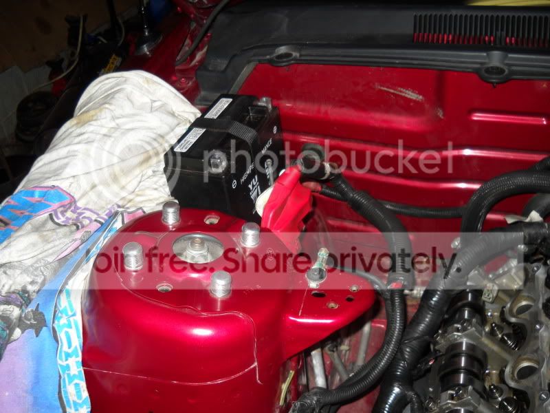

Underneath is a different car off google. You can compare how much more room you will have.
Another just to show the extra space^^Good glimpse directly at the headers right there too.
