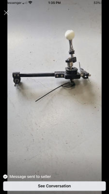

I found a MGW shifter on fb marketplace but I noticed it’s not the newest version. I did some research and the guys in the old threads on different forums said it wasn’t worth upgrading to the new one if they already had the older version. I’m getting it pretty cheap and it looks to be in great condition but wanted to make sure I didn’t need to just go ahead and spend the extra for the new version (I have a hurst now but it rattles like hell).

If you’re rocking the hurst now, then it will be a solid upgrade for sure. I first had the hurst on my 3650 and upgraded to the MGW, it was a lot better for sure. The hurst made all kinds of noise and when comparing the two units side by side, the MGW piece was just better built all around. I now use the MGW in my 6060 and love that it’s adjustable as well.

I’ve read nothing but good things about the MGW. I just wanted to make sure if I went with the earlier version it was still good to go. For $125 it’s gonna be hard not to pick it up either way lol.

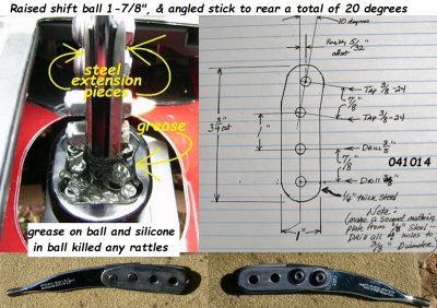

My Hurst rattled until I took the boots off, put a generous amount of simple wheel bearing grease on the top of the ball through which the shift lever extends, then I put a piece of flexible plastic (not a Walmart bag, but that would work) with a hole for the lever on top of grease, then put the inner boot on followed by the dress boot, then I put some silicone seal in the knob to fill any voids above the lever's threads, then I put the ball on the lever. No more rattles.

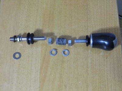

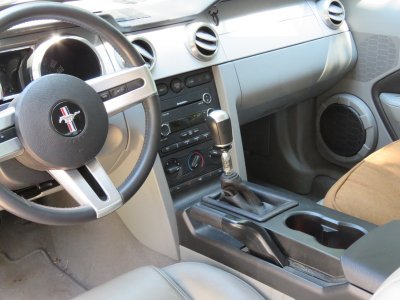

I did something similar to my MGW, which was precise enough but too notchy for me.
Too much drivetrain noise, so I insulated it all . . .
