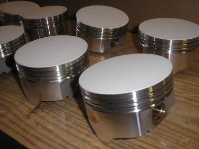

i'm trying a low buck HP trick.
I used VHT SP101 white ceramic header paint on the tops of my pistons. I've read about this in a couple articles way back and they claimed to find 20+hp by doing this and coating the combustion chamberas well. they also recommended painting the intake port but my heads are assembled so that's not going to happen but i will coat the chamber and valve heads.
when it's cured properly the ceramic coating should last for quite a while and is solvent resistant so the fuel won't make it peel or burn off
It's supposed keep the heat in the explosion instead of transferring it to the metal (pistons and head chamber/valves). this increases cylinder pressure thus making more power.
I'll never know if it actually made a difference but heck I had the paint here so why not?.
my wife didn't like the smell when i used the oven to cure the paint :)
curing process
250* for 30 minutes
allow to cool
400* for 30 minutes
cool again
650* for 30 minutes (my oven only went to 550* so that will have to suffice.)
here's a pic

HAHAHAHAHAHAHAHHAHAHAHAHA THE OVEN!!! good stuff :) :)

dem some purty pistons Ron!!!
