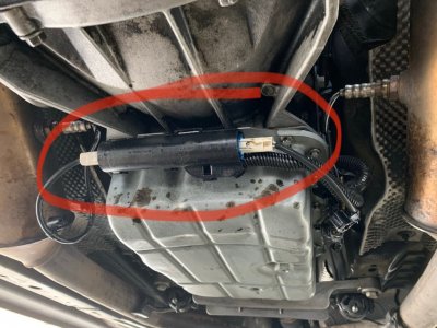

I re-read what you wrote. If i'm understanding correctly... Since I have now verified that power is getting to the fuse from the BEC, and EVAP CPV is no longer an issue, i now need to verify power is going thru the fuse to the connectors of the o2 sensors, correct?
Could the problem be one of these two components failing?
Anyone???
I figured out one of the components in the photos is the Transmission Range Sensor, which i dont think that would be the issue. Perhaps the other unit that the downstream O2 sensors connect to?

First picture where the O2 sensors go into that cover appears to possibly be fluid saturated. Have you used some electrical plug cleaner?
I checked all my plugs and all were cleaned with CRC Electronic Cleaner to no avail the codes would come back after a short drive OR after a restart. I checked everything, plugs fuses and nothing stood out, as a last resort I added a few hair ties(yeah hair ties) around the fuel door rubber so it can provide a better seal, rechecked all my grounds and added/replaced a ground(behind the engine to the firewall) with a battery cable... idk what it was BUT the codes didn't come back for almost a week..
When the codes came back I was DONE, I dropped the car at my local Ford Dealership to get it diagnosed... lucky for me I was told they previously had another mustang with the same issue, same codes, headlights dimming/flickering, and AC clutch engaging randomly, according to them turned out to be a bad positive battery cable... unfortunately later that day I receive a call with even more bad news, I was told that they couldn't do any repairs until they address a more serious issue, according to a technician there was an issue with the timing cassette on the passenger side, denied that repair($$$) since I wanted to verify for myself, removed the valve cover and greeeeaaat! found a timing guide piece just chillin next to a head stud...
