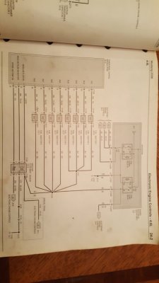

Actually it's not INJWRM, that is 07+ only. I can only check the Injector circuit. And yes, we flashed the PCM to a CDC3 for my old 4R and use the same for the 6R.15519255649592044565926.jpg

Well, if you don’t have INJPWRM, that’s why the PCM is setting that DTC. Can’t monitor that circuit if it isn’t there lol. Have you talked to Lito about just shutting off those DTCs? I’m not sure why they just showed up out of the blue, but it makes sense to just shut them off in the tune. No point in having DTCs enabled for a circuit and switch you don’t have. I assume the cruise control DTC is probably related to CPP because that is one of the inputs to deactivate cruise.

Ok, I see what you're saying. P0689 is setting because its thinking there is something wrong with the ISP-R circuit or the injector circuits are powered up all the time. Have you load tested or voltage dropped the ISP-R or injector circuits in any of your testing? Or have you just done static voltage checks?
I'm not even seeing P0689 in the PC/ED for the 2005 car. It only shows up in 2006+. What year is that strategy from?
Yes you have to use a 2006 and I've only tested that circuit static. I was under the impression looking at the B pinpoint test that that circuit will only need to be tested if you were getting a 685 or 690 though.

Looking at PPT B in 2006 PC/ED shows that if you have P0689, you should jump straight to verifying voltage on the ISP-R circuit. Since you are having starting issues, I would assume there is actually a problem with the ISP-R circuit that you haven't been able to isolate with static testing. Although the static voltage test seems to be fine, I would load test it and carry out a voltage drop test as well. Load testing is a dynamic test and will actually work the circuit. Ideally, we want to see less than 0.3V dropping across the circuit.
With that being said, I'm looking at an 05 wiring diagram and I can't find ISP-R either. It looks like the control side of PCM power relay is constantly grounded and receives hot in run or start power from the SJB when the ignition is cycled. Your wiring diagrams are for a 2006 and are very different from the 2005 wiring diagrams I pulled from PTS. ISP-R seems to only be present on 2006/2007+ cars.

I am measuring ISP-R at Vpwr on C175B pins 35 and 36.
Not sure why my car is looking for the clutch position circuit now as it never had before and we've used the same strategy for years
