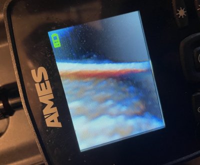

The first 5K miles I had my Edelbrock, I only had a catch can on the passenger side because Brenspeed told me that was sufficient. Two years ago, after reading the posts here, I realized I had to have one on drivers side. Obviously, my setup is not working well enough and needs to be modified. This was the first time I checked inside with the scope. Everything I can reach with my hand has been clean. This is what the scope found. B67E94C9-ADD9-4F8F-979A-9090884C5475.jpeg

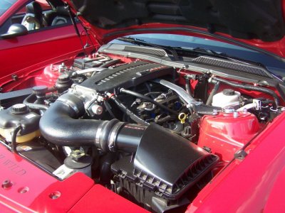

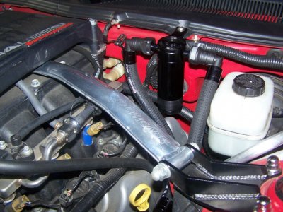

000_0534_eaf9b4d048c293b553de0d8b84e5a56a133b5d64.jpg 000_0540_384fa1913aa7b15bb10e90b75e7f806cfd2100c5.jpg 000_0532_c04b1893a6771b6a082521687824952ae7f8924a.jpg
Since adding the CFM oil cap breather with one way check valve along with the UPR 4 chamber catch can, driver's side only, there's been no crankcase oil coming out from anywhere.

Actually that pic is the old CFM cap with a K&N filter that I swapped out when the original got dirty. I have since then actually upgraded to the newer version cap because that K&N got baked onto the old cap and it didn't want to come off.
Yeah you may always get some oil drippage and mine is minimal if it happens. Seems like my passenger side breather is usually the culprit. I don't get much, if at all, out of the cap breather, even with the old cap.

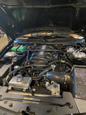

Hopefully, I’ll make the change this weekend and remove PCV. I can get another $10 breather from AZ and try filler caps with and without check valves to see if it makes a difference. I’m going to leave the two existing catch cans in place and just install a breather on them while blocking air intake ports. This should be super easy and fast. 4FC91B1B-8820-4A46-BC12-35FE95E48C7A.jpeg
