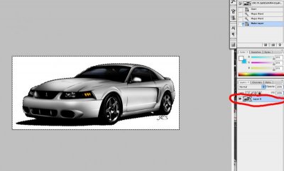

When you open up your image you must first turn it into an actual layer and not a background image. Make your selection to delete all of the background but don't hit the delete button yet... double click the circled layer and turn it into an actual layer (see picture 1)

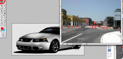

Now, you just hit the delete button and it should look as shown (see picture 2)

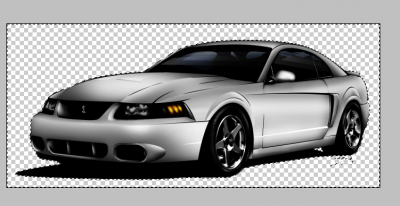

Now you open up whatever picture you want to be in the background and select the whole thing with a marquee (see picture 3 - note circled marquee tool)
Next just drag and drop that image into the image of your car. Note that the image shows up on top of your car (see picture 4)
next just drag the car to be on top of the background layer. You do this on the layer pallet by dragging the car on top of the background layer. Now make sure you have the background layer selected and go to Edit/Transform/ free transform (in my case) and you can scale the image to any size/shape you want to. hold the shift key to constrain proportions. (see picture 5)
I hope this helps. Another option would be to select your car and drag it onto a background of your choosing.

i have the pen tool i thought it was an actual pc thingy lol. ok i got the whole seperating image from background turning it into a layer. what i'm not getting is i opened up the image and it's in a seperate tab i use the marquee tool but it just moves the box around. it's also not showing up on the screen the same way your image shows were it's in a box in the same tab
nvm i fingered it out lol.
twojustins
Slow as turtle christmas
Aug 27, 2010
21
Try dragging your selected image to the tab where your car resides and hold it there for a second to see if it moves over.
