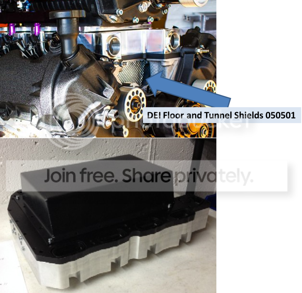

After quite a bit of research, decided to go with the complete cobrajet setup. Jim at JDM was quite helpful. I also purchased the heat deflector. It will have to be trimmed a little to fit since it was for the smaller tube. The one in this pic has been trimmed.
My ram air hood dumps right there, so should help keep cool air for the intake.

Is the wrap still recommended or is the pan design improved from what Jim had?
Department Of Boost
Alpha Geek
May 26, 2010
8,809
28
That shield is independent of any pan/manifold design. All pans/manifolds will conduct heat.
I did some bench/rig testing on a bunch of heat shields/coatings/films/etc and that DEI stuff was head and shoulders above the rest.
I've never done a A-B-A IAT comparison though. I'm not even sure if I could devise a test that was consistent enough. I put that heat shield in the "It sure doesn't hurt" column.

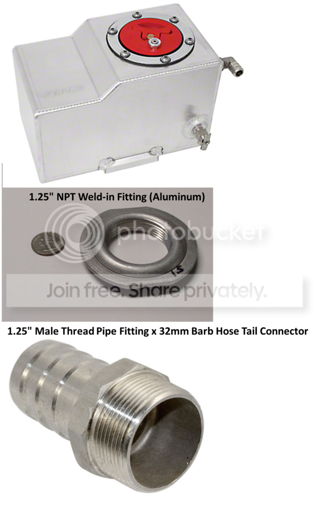

So, lets say that a guy really wanted a battery mount intercooler tank. You could pick up a moroso tank, shave the two stock fittings off the end, redrill and weld the 1.25 fittings on. Am I understanding the 1.25 inch correctly? That is a big goddamn fitting!
Department Of Boost
Alpha Geek
May 26, 2010
8,809
28
That could be used, but that tank is way too small for the space and mounts like crap. And you still wouldn't have the pump mounted.

Got your e-mail. I had a knock off of the moroso tank modded to be my current coolant tank. Nothing bigger would fit with my UPR aluminum battery tray. Thanks for pointing out the one for sale, but I would not be interested.
Pump wise, I think the Davies Craig EWP150 is the way for me to go.
Does the Davies pump mount on the tank or can be mounted anywhere?

You could mount the EWP150 right to the tank. But it would take some custom machining/welding. It is the best place to put it.
When going with 1.25" lines and a tank mount the Meziere is a god choice. It is already set up for a surface mount, packages nice and flows withing 1gpm of the EWP150.

The more I dig into this, I think a half moon trunk tank is the way to go. Since I like supporting forum vendors, PNR welding makes a nice tank.
Would you mount the Stewart pump right on the flat side of the half moon?
Would you wrap the coolant lines under the car?

You could mount right to the tank but it requires getting a mounting plate machined. I would just weld a 1.5" nipple on to the tank then run a very short section of 1.5" hose between the tank and pump (the pump inlets OD is 1.5"). The really short section of hose will act as a mount and you will get a really good feed on the pump with a hose that big. When you add the outlet line "strap" it to something close to the pump. The pump will float a little but it will be very rigid. That's a lot of hose support for a very light pump.
Unless you're planning on running the lines near the exhaust you don't need any heat shield. And argument could be made that if the water is as little as 1deg warmer than the ambient temp you will get some additional cooling through the surface area of the line.
And you don't want to bulk the 1.25" line up any more than it is already. It's already tricky to run.
