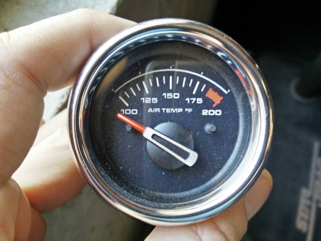

I have a 15 psi saleen extreme gauge that I'll sell for cheap if you're interested. I have the dash pod and the AIT gauge but I've been contemplating getting a mechanical gauge that shows vacuum.
It is the newer style with LED backlighting.
$25 shipped if you are interested.
