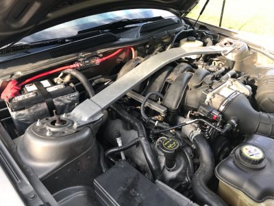

My guy did a custom 200AMP alternator w/4 gauge cable and inline 250AMP fuse for me and then bench tested it in front of me... He showed me on a scope machine (I really didn't know what I was looking at...) that the alternator is taking in and producing the proper amount of current without any fluctuation. This up and down or surging is what cause our modern cars to have electrical problems.
