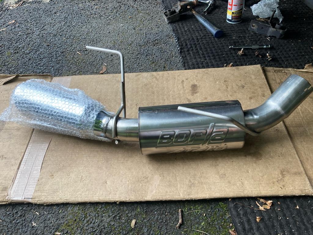

Here’s a picture of the ATAKs, they’re a straight through muffler. You can see daylight looking through them

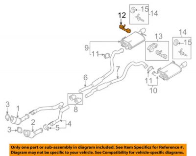

Perhaps I am dense, but I am having trouble understanding the "uneven split H pipe" discussed by tabstang.
Would you be able to provide a quick, simple drawing showing what you are referring to?
THANKS!
tabstang
May 15, 2017
119
43
Looking at this I realize I mis- remembered, we put it just in from off the axle , the longer the better - so just behind no. 7 in this diagram.
