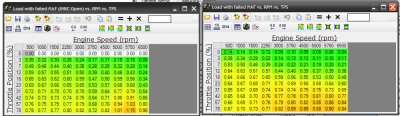

Does the HPT give you access to load w/ failed MAF table? Last time I checked it sure didn't. That table is priceless when you add Cam's and larger TB's. If you don't have dealer training from SCT and the calibrator dongle, you don't have full access to PRP.
P.S. - I don't dislike HPT, but I just wish it was as complete for Fords as it is for GM's. The next best thing to EFI Live is HPT for GM's in my opinion.
As far as I can tell, yes. Do you have the latest beta? The ford stuff is in constant development.
