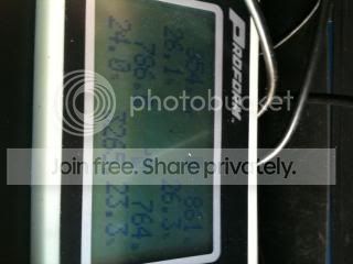

Car Weight with 13 gallons of gas and 215 driver = 3,265lbs
They brought it to the track tonight and it wouldn't hook off the transbrake. I am running some 275/60/15 MT Drag Radials and they are not cutting it. We are about to start on the suspension settings before we put the turbo on. I have BMR everything but still have stock shocks with Steeda Ultralite springs.
Track Times:
60' = 1.8
1/4 = 12.0
MPH = 114
