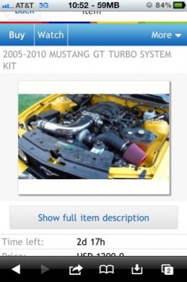

Hey let me first say that I did search and I can't find it. I need a write up or help on how to relocate my stock reservoir in my engine bay. Here is a pic to see what I mean. I plan on starting tomorrow if I can get this figured out.

One eye willy did a write up. Its really easy just need to make a bracket and turn the lower hose it will reach and extend the upper vent hose some.
I moved mine as you can see in my sig pic.
