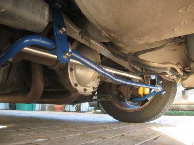

I have Granatelli 36mm Front adjustable sway bar and 25mm Rear sway bar kit. They appear the same or very similar to the Ford Racing.
When the rear bushings wore out, I had a hell of time finding a replacement. It took me a couple of different bushings but these fit lower and upper sway bar bushings perfectly. They come with brackets, but I didn't use them as the ones I had are still good.
Moog K90400 rear sway bar bushing (They are from a Honda Prelude) LOL
I have an extra F/R set of sway bars for sale on this forum, but shipping to Canada would be $$$.

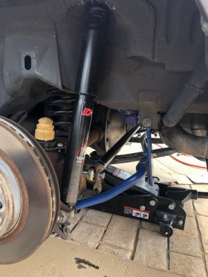

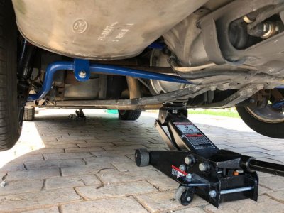

These are the ones I have now on my 05' GT and on my now defunct 06' GT Convt.
Note: The GT500 Track Pack Bilstein's, adjustable Panhard and brace!
