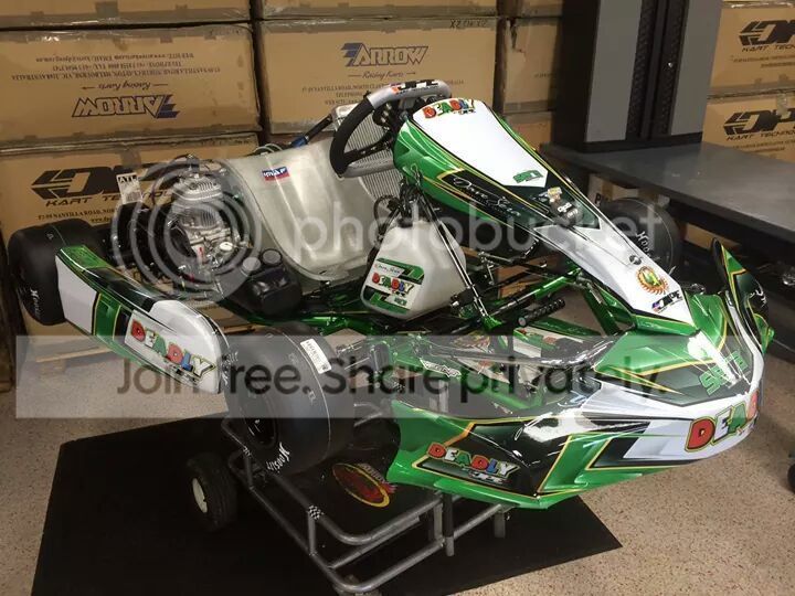

My kart the day I bought it new and ready to race.
