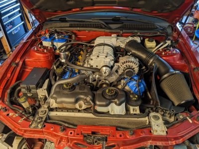

Been searching for days now, does anyone have or can test the throttle body motor resistance? I'm getting 3 ohms on mine and would like a comparison.
Background info: did a DOB install and my throttle is rapidly clicking and causing PCM communication issues

So I finally figured out the problem. Spent the entire day combing thru the workshop manual, coming back with everything checking out good. Checked grounds, wiring to and from PCM, TPS and throttle body motor, relays, diodes, alternator, swapping the old TB in, and found the car would start and run (poorly) without the throttle motor disconconnected. Connected, communication failed with the cluster and no mileage displayed, fuel level errors, all because of a blown fuse. Engine #3 fuse. Should be all set now.
Dieharder, yes, a GT500 TB. I actually got away with not extending the TB wiring, so it's all stock in that respect
