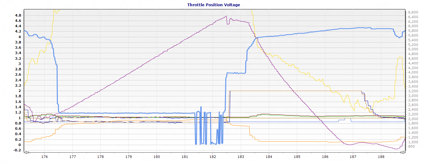

My car just had an issue where it went into limp mode because it saw 0 on the TPS voltage, voltage had dropped on a wot run and zeroed out. After restarting the car, everything was fine, drove home without issue.
I've cleaned and checked the plug, the operation of the TPS, and am adding a second ground strap (since the TB uses a chassis ground) to see if that helps. Otherwise monday the accufab TB gets shipped to accufab for repair.

Just tried it again, and same result. As it hits 6k the voltage goes away.

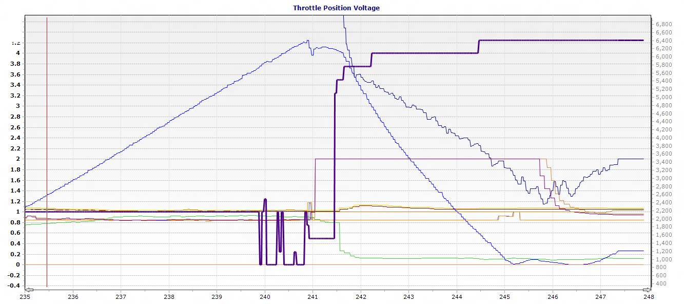

It *still* does it. I've fixed that ground issue, and installed new o2 sensors, cleaned every bit of the car and checked all connections, reflashed the ECU, reset the computer.
The weird thing is, the only way to duplicate this is:
1) have livelink running
2) start the run at 2000rpm in 3rd.
I need to do more testing, but if I start higher than 2k, I seem to have no problem finding my way above 6k (all the way up to 8).
Anyone have any thoughts? Or a spare coyote throttle body I could test with for a week?

I bought a new stocker. Should be here next week. However i did go back to the spot and do a run in third from 2k-8k. No livelink or anything plugged into the odb2 port. The run went fine, no issue, no cutout. I didn't duplicate it but this is at least something (it's not easy to find somewhere you can do repeated blasts up to 100mph)
