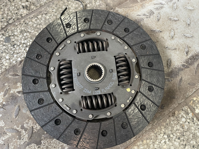

I have bought mustang 2014 GT 5.0 and now have to replace clutch (its slippery) but problem is I'm not sure what to buy.
Car is little modified (watts link, torque arm, rear lca, bump steer kit, coilovers, bigger brakes, roush stage 3 supercharger...)

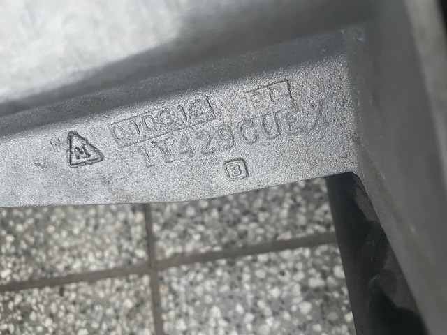

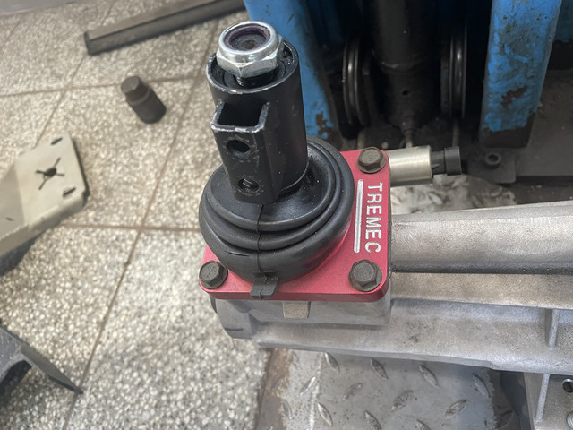

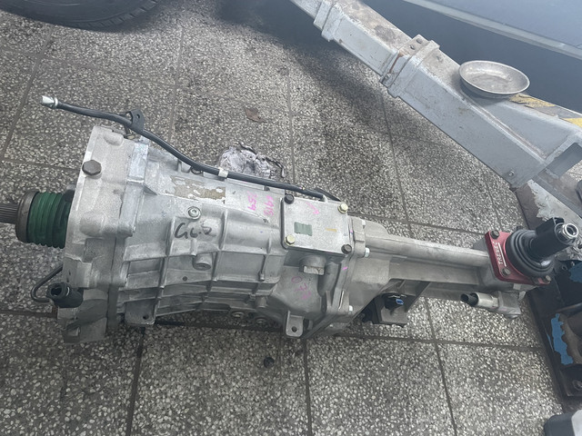

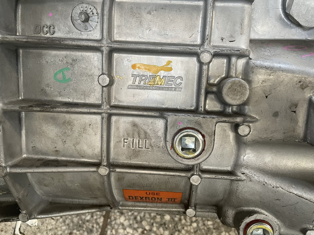

Transmission is Tremec (original is MT82 right?) so I am not sure which clutch to buy (original is 23 spline and for Tremec is 26spline?)
This transmission is Tremec Magnum XL?
Clutch is 26 spline? So I can search for GT500 clutch (does it fit my setup)?

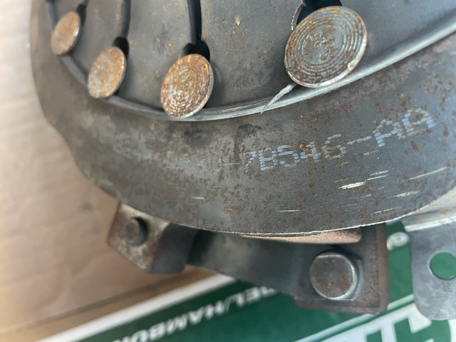

few photo of current trans and clutch
Thanks a lot for any info ;)

Yes that's a Tremec T56 Magnum. I think the McLeod RST is your best bet for street use, or the RXT if it's more of a drag strip car.

DF148500 is what I am running. 5.0 wTremec magnum xl.

What are you doing with the flywheel? The lightened steel ford racing is a nice upgrade. But a resurface is a must, dont just replace the clutch. No matter what you decide to get.
sorry, what do you mean by resurface of flywheel? :oops:

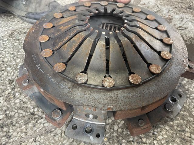

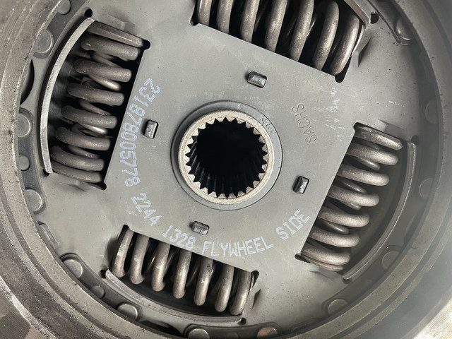

single clutch is ok when orig is double clutch?
Flywheel should be machined or replaced.
If you have a dual disc clutch, it is not OEM. I dont think any stock clutch was dual disc.

so clutch is 26 spline, right?
is it ok to choose clutch kit for GT500 2014? or it will not fit to GT with Tremec transmission?
I believe that is the same clutch, as the GT500 has the 6060 trans. Which is essentially a magnum trans with a different shifter layout. Just confirm with the seller to be safe.
