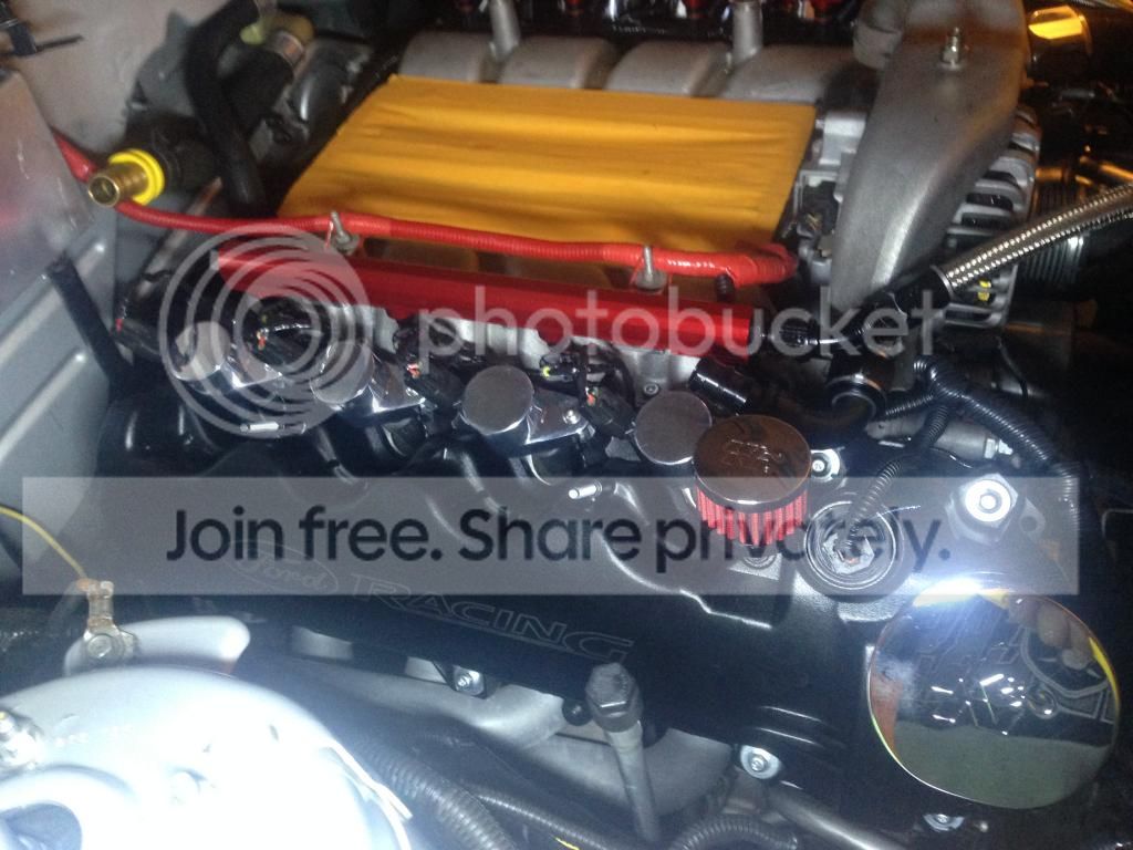

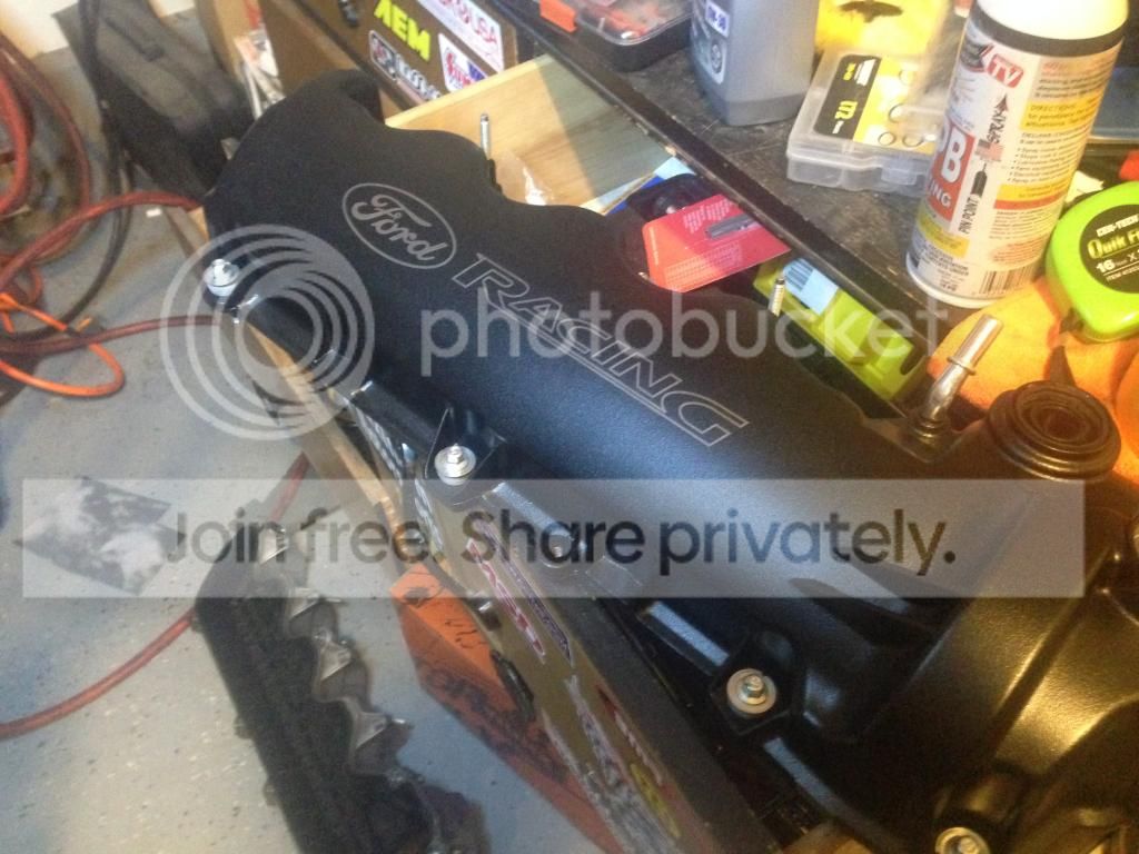

I think you're reaching a bit here. If it was stuck closed and building pressure two things would happen. One, you wouldn't have any oil in your tube running to the intake. And two, the flow would simply reverse itself and go out the passenger side. But if you want go buy a set of cam covers. Get the laser etched Ford Racing ones, they look cool. I got a set but I cut my pcv valve out of it. But it won't get your car to start. Do this. Cap off both the intake where the pcv is connected and cap off the intake tube where it draws air into the passenger side, then start your car. Bet ya it doesn't make a difference.

If it's open it won't cause any pressure build up. Two, if it's stuck open it will only draw when it is under vacuum which it does when it's working properly anyways. It doesn't prevent anything from flowing out just from flowing back in and keeping the direction of air travel the same, to keep it from reversing. It's just a check valve, like back flow prevention. But since you know what it is, go get some new cam covers. These preferably, they look sharp.
But if you want to test your hypothesis go get some vacuum caps for the vacuum ports. Just go get an assorted set from autozone or oreillys.
