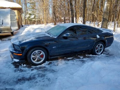

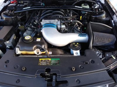

It has a BBK intake. At like 1/4 throttle, there is power and the exhaust sound gets loud, in a good way. Nothing in the glove box but the owners manual and the trunk has a dust cover for the car. The transmission is a manual. Clutch pedal has about an inch or maybe a little more of free play at the top. The calipers are red, was that stock? If was driven decent, how long can I expect the clutch to last? From what I have been reading, these cars seem fairly reliable. Any preventative things I should be doing, other than regular maintenance?Mustang.jpg Mustang1.jpg

Calipers were not red stock. Car appears to have a chin spoiler and an aftermarket strut tower bar. My stock clutch lasted about 145k miles. It died pretty quick after the supercharger. Inch of free play at the top of pedal travel is normal.
It sounds like it has a tune on it. With the Bama tune I had on mine a while back, the car was at 100% throttle at probably 65-75% pedal.

the calipers have a cover over them, they aren't red, just covered, not stock.
impossible to estimate the life on a clutch IMO, travel sounds about right AFAIR
there's also a chin spoiler on the car that is aftermarket.

That car has a BBK CAI, Hotchkis strut tower brace, MMD chin spoiler, and stock brake calipers that are painted red. The touchy throttle response suggests that the ECU has an aftermarket tune 'cause if it had the stock tune, there would be a slight degree of throttle lag.
