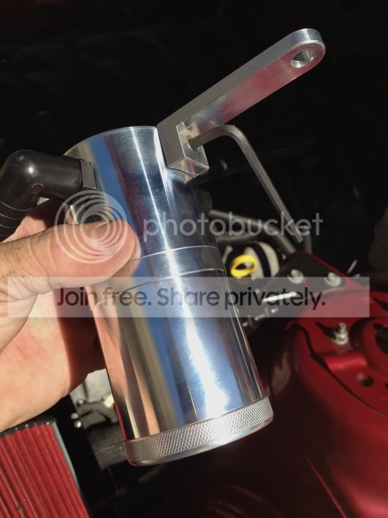

The first step is to install the pipe plug in the bottom of the can. (allen wrench is included) The bottom of the can is tapped in case you want to run a drain line, which is a thoughtful addition, but I'll just drain the can every time I change the oil, so I'm not running a drain.
The next step is to install the mounting arm. (again, allen wrench included) I wanted to make sure the mount didn't work its way loose, so I used a dab of Loctite on the screw.

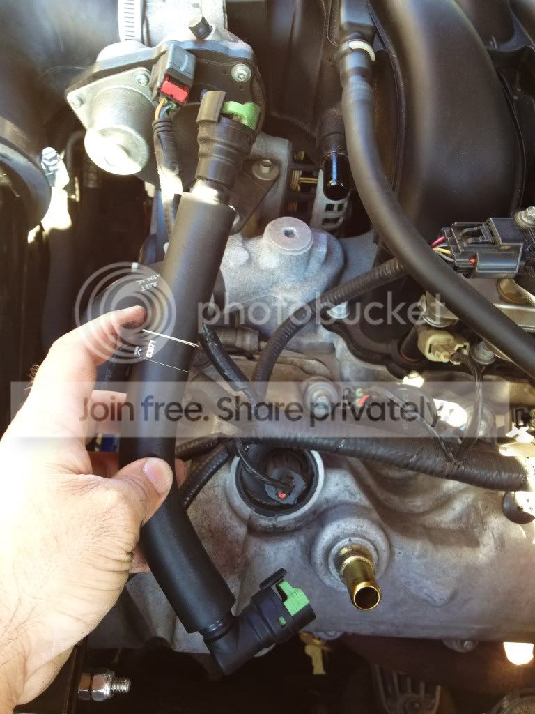

Then you remove the factory tube running from the driver's side valve cover to the intake manifold. (no tools needed, just press the green tabs and slide the hose ends off)

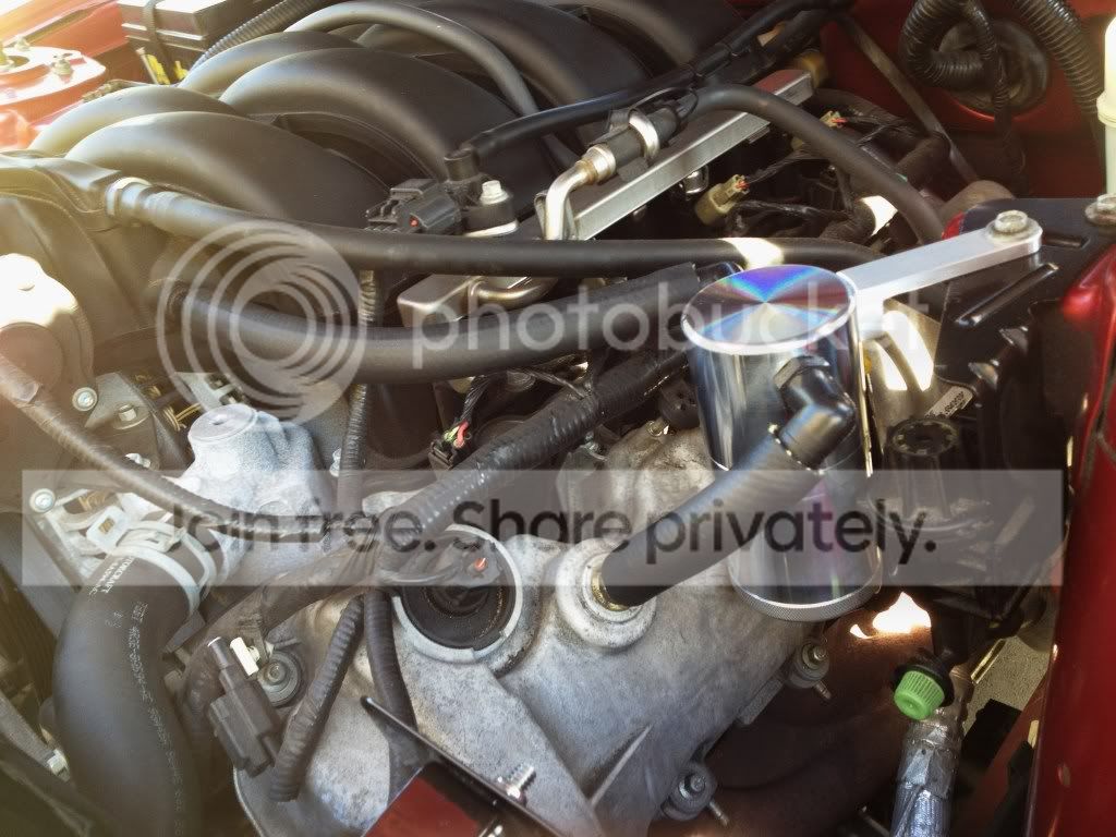

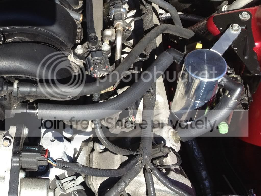

Cut the hose (included) to the proper length, slide over the barbs on the 90 degree fittings, and slide onto the tube coming from the intake manifold and the tube on the valve cover. I thought about using hose clamps here, I even thought about re-using the factory hose ends with the green clips... but when you install the hoses like this, you'll see that they are not going ANYWHERE!
From this angle, it looks like the can is a little close to the valve cover. Just to satisfy my curiosity, I unscrewed the bottom of the can like I would do to empty it, and it came off and went right back on without using any tools or moving anything around. Nice!

Here's another view:
