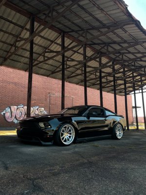

Okay so to start, I have a 2012 GT that sits very low to the ground. With that being said here we go; I'm cruising down the interstate, I notice something metal on the road around the size of a dinner plate but much thicker lol anyways , I had no way around by the time i noticed it. I ran it over and it caught my Output speed sensor wire, ripped the connecter out and broke the female end off (luckily it stayed in transmission). I pull off the freeway, jack the car up, pulled the metal out. Heres where i probably messed up, I drove it home due to not being that far; gas light was on, speedo didn't work, shift horribly(manual), CEL and service engine light were on and basically was in limp mode due to misfiring. I get home, replaced the Output speed sensor, crank the car and go for test drive. Speedo works, all lights off, cars still misfiring, seems like very large power loss above 3k. Next morning CEL is on. I have these codes, P0010, P0013, P0020, P0023, and o2 codes. Keep in mind car ran mint before this, no lights nothing.
Did the OSS getting pulled out trip all these sensors? Did I possibly throw time some how? Did thepull of the piece of metal maybe tore the harness somewhere ? Please help, truly don't know to start and last thing I want to do is hit the dealership.
