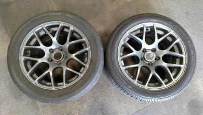

Got some older tires mounted/balanced onto my spare set of wheels (AMR 18x10's).
Should be a smoky summer :)

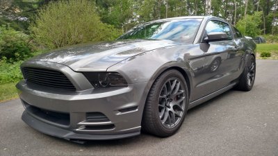

So, yeah, yesterday I installed some new-used 18x10 AMR's with Goodyear 285/40/18 front tires and some 305/40/18 Nitto NT555R's on the rear.
(pic 2 posts up)
A little more info:
Small 4-5mm spacer on the front.
No centercaps because they're the world's ugliest caps (the chrome 'AMERICAN MUSCLE" ones) and I plan on doing something to them to get rid of the chrome and maybe even of the wording.

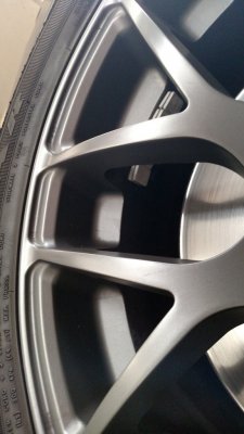

Had a small issue on one front wheel, it took so much weight that the shop put 2 rows of 5 weights next to each other (side-by-side) and the inner row was touching the caliper. Had to remove those 5 weights, remove the tape off the back, add new 3M double-sided tape and stick them on top of the first row of weights. Hope they stay there. If not, I may have them break down the tire, rotate it on the rim and try a better balance with less weights.
Sure enough, the Nittos run a little narrow, the Goodyears run a little wide
285 GY's and 305 Nittos:

I had those wheels static balanced with no TPMS sensors (to reduce the weights needed) and only had weights put on the inside of the wheels. Only way they'd clear the Brembos.
Still no sensors, but the outer strip of weights clears, even now doubled up as it is:

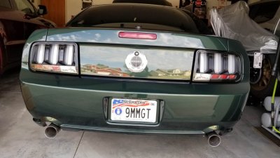

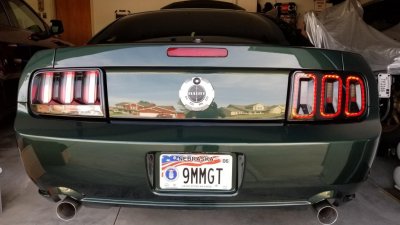

TailLights1.jpg TailLights2.jpg Swapped the Raxiom Gen5 LED tail-lights for Gen7...bought from a local CL seller so thought it would be different from other's who have the Gen5's...

View attachment 67439 Swapped the Raxiom Gen5 LED tail-lights for Gen7...bought from a local CL seller so thought it would be different from other's who have the Gen5's...
To each his own, but that style taillight does not flow with the otherwise boxy hindquarters of the S197.

Overall, I also think the gen 5 tail lights look much better on the S197 over the Gen 7 style. IMHO the tri-bars of the gen 7 just don't blend in very well with the lower reverse and brake light sections at all, nor do they match up properly with the upper section of the rear bumper :shrug:

I'm one of the people that like the Gen7's better than the Gen5's.
Especially since the LED's in the Gen5's are not continuous, they have all the little LED's individually visible.
I guess they saved 3 cents/taillight having the Chinese manufacturer build them that way.
