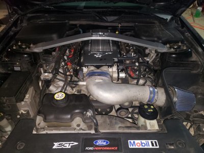

Yesterday, I did something I hadn't heard others do, so I thought I'd share.
My aeroforce obviously reads intake air temps. And, I have taken real steps to lower those temps, including a GT500 pump and a VMP dual fan HE. But, I wanted to know what temp the air was actually entering my KB intake filter.
For background, Kenne Bell runs its intake down behind the front bumper to get "cold" air. The problem is, the air is turbulent down there at highway speed and can confuse the car if you were to coast at highway speed. So, if I was to push the clutch pedal in at 60MPH to coast to an upcoming light, the idle would get all wacky. The solution last summer was to build a shield around the air filter. Hurts the "cold air" concept some, but it fixed the turbulent air problem. And, as a side benefit, protects the filter if I get caught in the rain.
So, to present day, I bought a Gentex 341 smart rearview mirror. It has a compass and temp readout built in. I then ran the temp sensor to that aforementioned shield and installed it there on the inside of the shield right next to the filter. So, on my rearview mirror, I'm literally seeing the temp of the air 1" from the intake filter.
If you're curious, the air was sitting about 6-8 degrees warmer than true outside temp; the shield cuts out a lot of the outside air and unfortunately does get some of the engine air above it. When I started the car yesterday, it read 73. As I drove around, it settled in right about 79 with some +- fluctuation. My IATs hovered in the 110-120 range.

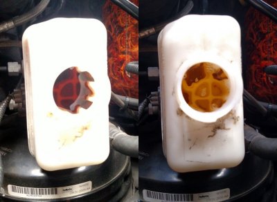

Yesterday. Flushed the brake fluid in my Mustang. Fresh Motul RBF600 in, removing the fluid that I put in at the end of 2016. A little overdue for this stuff.
Old and new:
And the old stuff, after the flush was done. Can see some of the fresh stuff still in the tubing going to the jar, nice color difference:

Motul RBF600 is the best there is. I ran that in my Ducatis and lots of track time. Thanks for the reminder, I'll be doing this to mine too.

I have to do that, my brake fluid is blacker than my soul.
I don't have a vacuum bleeder though.
Neither do I.
I bought some 1/4" I.D. flexible vinyl tubing from Home Depot, used a section about 2' long, attached one end to the bleeder screw and put the other end in a jar that already had about 1/2" - 3/4" of old fluid in it, which I sucked out of the master cylinder using an old turkey baster.
Then opened the bleeder and went into the car and pumped the brake pedal about 20-25 times, making sure that I don't run the master cylinder too low to have it suck air in.
I have a video but it's boring since you're basically looking at a fluid traveling through clear tubing, about as much fun as watching paint dry.
When I was done with all 4 wheels I had the wife pump and hold about 3 times per corner to make sure there was no air in the lines.
I used 3 bottles of new fluid and a few feet of tubing. Plus the 11mm wrench.
Nothing else.
