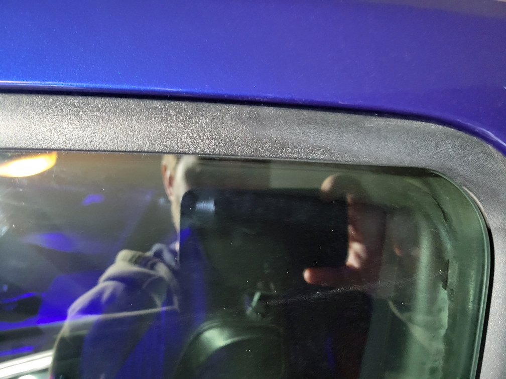

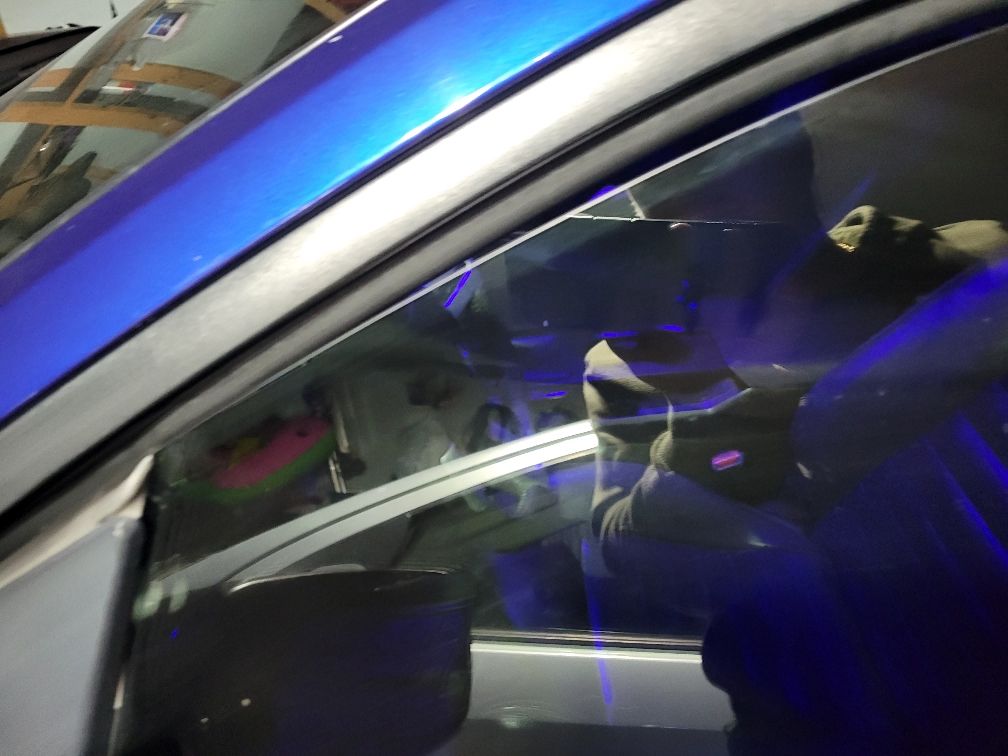

Window all the way up when it open in the first two pics. Is it all the way down the the last pic?
