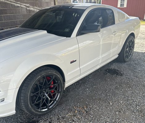

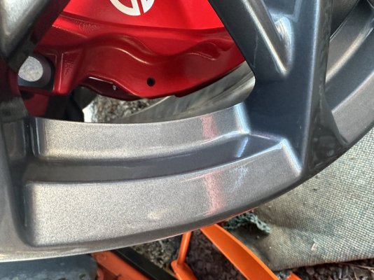

Well it’s been a while since I posted to this thread, but I finally decided on my new brake setup and got everything installed this weekend. I want to thank everyone who responded with their feedback and suggestions.
While I was originally planning on using 4P GT500 Brembos, I ultimately ended up going with S550 6P Brembos. I did A LOT of reading here and on TMO regarding these brakes and some of their drawbacks (weight and longer pedal travel). For the way that I use my car the 4P would have been more than adequate; the 6P are really just eye candy over the 4P. Again for the way I use my car.
These are the parts I used:
Front:
- S550 6P Calipers
- MotorCraft BRRF218 Blanks
- SS front brake hoses from LMR
- PowerStop Z26 Pads
Rear:
- MotorCraft BRRF262 Blanks
- Rear Caliper Brackets from LMR
- PowerStop Rear SS Brake Hoses (already had)
Flushed the entire brake system with Motul 600 and the old school 2 person method (I think my son still has leg cramps)
Happy to report that everything went together very well without much drama, it was truly a plug and play install.
The only issue I had was bleeding the rear calipers. I had my son press the brake pedal to get the rear piston to come about half way out and then I cracked open the bleeder screw and wound the piston back in. While doing this the piston seal kept wanting to rotate with the piston as it was retracting back in. I was able to get it most of the way straightened back around the piston, but not 100%.
So how to the brakes feel? A lot better than before! The pedal is very high with very little dead space before engaging; 1/2” or so maybe. It’s actually not bad at all and I am someone who prefers a stiff pedal that engages right away. Slamming on the brakes (panic type stop) will nose the car forward and engage the ABS now. It’s also nice that the pedal can be modulated and the brakes are not an on/off switch.
Installed new tires and wheels as well with the brakes. Wheels are SVE MHP1 19x10 +35 and provide plenty of clearance between the calipers in regards to the spokes and barrel of the wheel. Wheel poke is negligible.
Tires are Bridgestone Potenza Sport in 285/35R19. I picked them up at TireRack on clearance for $148 each because they were 2020 production. However, when they arrived the date code was 0422, so that was a nice surprise.
Overall I’m very happy with the brake upgrade; I was concerned about having a 12 foot pedal travel or a spongy wet noodle feel, but that has not been my experience.
Not sure why some of the pics are getting rotated, but hopefully they’re clear enough.
For now, car is at stock ride height on its OEM springs/struts/shocks. Waiting for some warmer weather and time to put an entire new suspension under the car. I already have the parts, just not the time LOL

Just a thought, the dead pedal travel originates also from the the floating rear axle shafts, they push the brake pads aside.
Nice wheels
