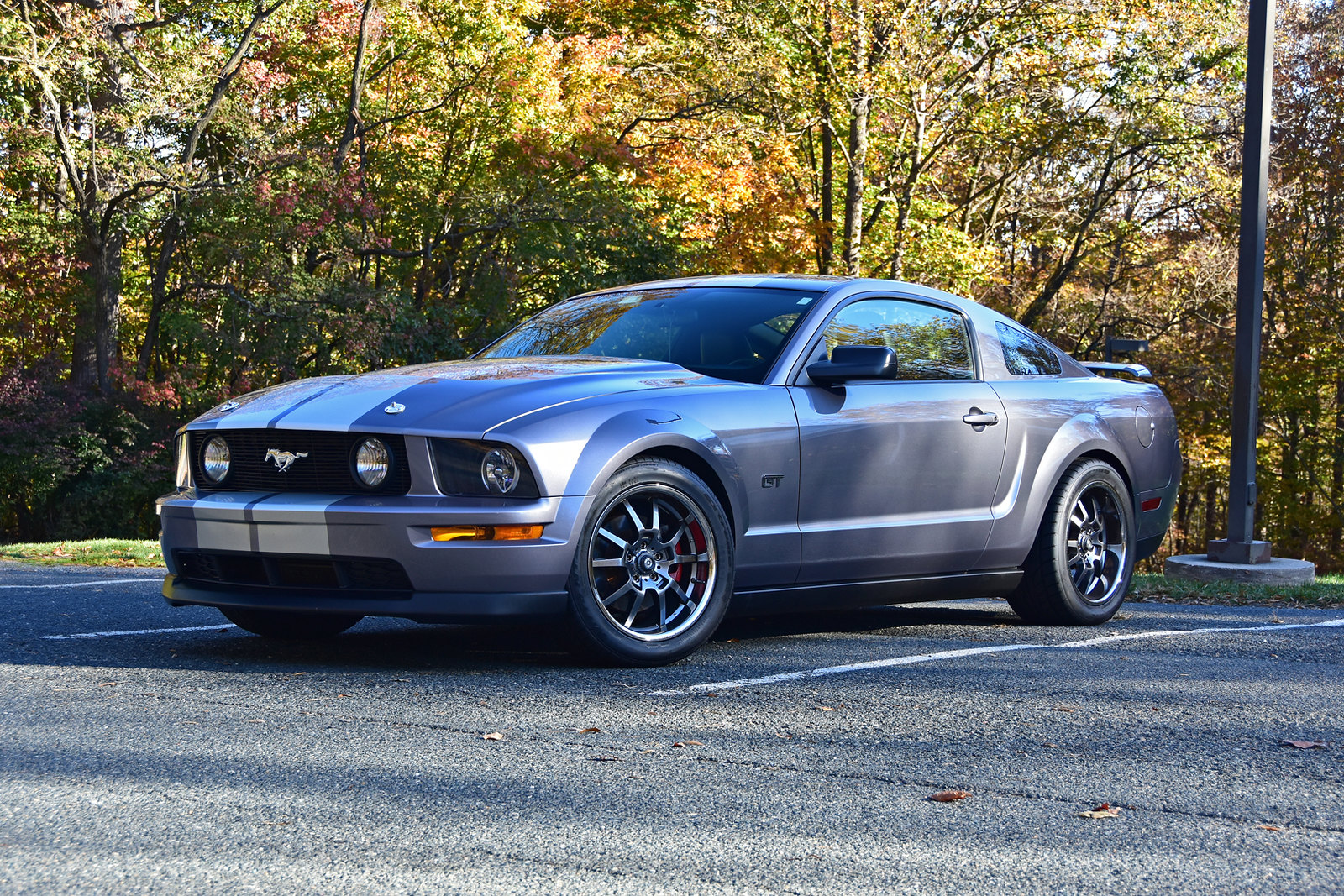

Nope, never did. I asked around on other forums, tried some stuff (the Great Stuff foam does eat plastic wrap) but ultimately gave up. It started looking expensive, and then I bottomed out the chin one too many times on a deceptively steep driveway and the paint started cracking off.
I tried reusing the stock grille right after getting the spoiler years ago. The problem was the CDC spoiler has the grille surround built into it, so if you trim the stock grille enough to fit, you've completely cut off the stock grille surround. You'd be left with the flat honeycomb sections, which I guess is a start, but how do you mount those?
In the end, with the cracked paint I plasti-dipped it and liked the look. Started researching grilles again and then found the MMD spoiler on American Muscle. The opening still sort of had that oval shape I liked about the CDC aggressive spoiler, but there were no modifications needed for a stock bumper so I could get another stock grille. In a lot of ways I like the new one better, the size looks more proportionate and I like the cleaner look.
[/IMG]
Repairing the damage from the CDC definitely took some work though.
-Lu65hTLqqcLdIouS9Y0j5G1SZsyoO6loKQYzZmq74mn5yZBRN1VHqb0lMbx0cdsBZ0Vt81FA4OrQm1yjY4qWH4lSOzyQ8IsSDcLCkVs448uZRcttyhEp9kWeqN6XF7Z70DqZJy9TQ3QqVcgJT3WTSfsi_66uT3FzBK-9o2hcrtG2hcUL_CKO8lvxVJwWz12LglvXrFcYgtLEKCZgzSQFbZwD9H5-8-Z_PKzk3-fDqWDcTPdiKo6KrkjP2pLFLleWtl2HVsGcB9r6TpxD5uXhONM39-_jr1TkOcp7ZJbYeSOs8hviQWyHXeF47hf0aZLzxNhqQ6En21PbE-ZjedIdeEUPQSZyZqeuzEtpxGXlsoODDuvlU04IP9f5-i9zYpdrr72paRlNw2IqxdRn4cCZO_HYkkOJ77l7hxf9ZHFWKskaBlhFSOn8ALaBOclHp9y7o93cq6uBFz8LkDYrIQVSDNkAz2DlLU0zvlmZkSKPMEi8Uk0KH2XmdkTSHEIKd376jPHqocgUJMLrUrZXjdcFEBndGMXWkZU23LeGQkd2BZ7CFVR9qQE6TDu438rjHbS3KZI6N2XcJWUD11xHVu0-shnjIhaHMpn1jfq0IsL=w2448-h1835-no
wsB6lTI1Q5SlPgqTLp1uUB1GMP3KVdg8NdAq8afbzVw8VxWkmylpIKVdUKX60iZ9CUbkXs0Xfbj68J9ZLbwNRlQK5apfS3TDYdoiTV937oWKLr-7fqb9cEc6szq1U9o6UK-WD6JU9_jcpd6K8i90OMF563MpRN8QB7APCpqefXL1YPcuTTuXnTJxwJRKiOsNM63KfQViYrdqW7akDlB8xPenkWYeWa0KATbuv2RwAys4LP0122pQsfBho17g_2JLFUNgZhfto1imKDTbG_5zhjgCxR2eflkF1MfrEuzAeTfVzgY5uYH1O-HzT7i-IYrWXngK_6CNQW7Apb4t9oblQM5lZEAWXqb91W3Zkd93KaTAR4ZQqnsG2wQhDeTWbyLPo9LEg0EiM09NHbNC8Eloa1ho7BajK8hR2CwiXJCcL0cTmbV8j6hfmUyqQgCrKsfv6pdzpf5fiXQFMzc72KDwQMqtw3K09Etyme6RNK-gYT_aB9Hk5Tynqix7jsKZP-Xj942M57ilRxTsQaNn4ehNKjLmzDy1r-E94We2XQJlwTfxO_buJdKZeFnOjNzV2oTLOd5zH8mOey20A1wbqGD2Q51yH4sMTzsqWU5y4bTT=w2448-h1835-no
It involved aluminum brackets, clamps, a heat gun, epoxy, cut up Ikea cutting boards, and lots of blue painters tape
GxqfyUXh_xUcFgjB30dpiXYifoN5QCA5QPpd0jfHBvUBj1eE6lwN-1NvMX1QKwo78X62Fww2tqUdS6lMgN-5iPjrcAW7GXZfY8-zIOxQ4EhQ2lk08VMHwStfqvPnnX5xCO36yEgmvqtebarqflh_fxmTeMb2pdN7w9gMdkRHTXsDJ0O8HucJ7iKayzY17H0xpmxUZQ68uNcQOUiJpWh_6TQ5iZ-i5bELW7tRLRrcSKWA1xfth3QuUVUUPNBclkNj68GS4uN-o_2zHNwKYBDB6rL-X-zyk3E2RlH_PsvNYvgotWN0IhuJmrP3a9njZN4aoVBuO9M4xPP0dVlnzRN-zQ-PX_jUyyVJ5YhbmZdbnYX67l0-tPG-889pQLT5MDTBNuvk1oWjjGsjFyzaCLk5K5gWmghHLEaHEODoopGyLV54zLYZxCLBzKoOzPgtPxcLkSmEGoLsYfDgOMFNHF8sE6jUxAKfjTfjKe9l_vYwO7_RH98ZXHpVVOUYDRKzpCaXh58bHeXj19SOuyPoUh8ZVNYJM24GU0Re9l95l0KehLVNFGiUtI8KSeNmVGAxdK7NsvAYEp6Z70u1EJF_kKOInWz_Fpvh9oJR9_kmOR3f=w2448-h1835-no
QHcCczHaKAR-GgpCygUrn79apEH90O1Ckt3iNcyBvmWIzIZBCTADUg1N6EA8M2-uYEyjqa0PG47d6Lp8MyoIY_kKODILEZTbPWuY_lkUMAj3PXaT5H239pWWvNrpG5Z_9KP2mMpJjmcdDzxiugHKNBtY7ERWE8STB2baiWpEhOmvyepwqBu8ozJ7gPvg11S_h2eMnipVag4VsmgYscJYZdC-ZyC9XLcT65SxfzGqKUeSN_b6zkq2G5M0KG2X6F9mxWwGBuvSpgP4cJRdzAB5zjzFNsvXRw6_7Fsrl_tEUFTgJjeilk0cz7gSdyv0pRkQmR2FcGNbss-3Kz4EqS11VeSPFftOha648nmutp66SGeKtcuC1-2vgNCb_epYlQAOI-MA6GUillsmM5vnGdst4w98HCrXkahpfqZF7IGXjCssPlieCHn9wTWKaPWIpopHDgVUOMta9oipnhjxOsRDAlGMm4TPKKxbs2BvyWtOomy8nOjcWdfeRJPxSM6G9NDXptX_qxpqaG5oJ7HgpUdR7nO33X4iT_dgcmdUX9WPf62Kl4ugCwXfMi6DDhJKPZkWUtTJeCURJAfh-JWti8BaaTcNh3blyyHw6FMlmN5D=w2448-h1835-no
There turned out to be so little structure left to the bumper that the only way to keep the stock grille in anymore was to bolt it in place using the same cap screws that the CDC spoiler used (and you can see some small air gaps between the chin and the grille):

Interesting... you look close at the pics of that replica on the car and you can see the cap screws on the side for securing the CDC's grille surround, but its hard to tell if there actually is one in the pics.
Personally, i'd be more for the urethane. the MMD on my car now is ABS and you can tell all it takes is one good wack on a curb and its going to crack. Nice thing about it though is it isn't much lower than the stock bumper.
Your bumper completely stock right now? It looks like that eBay deal fits a lot like the MMD one, so you probably don't even need to do any cutting, and you could keep the stock grille.
