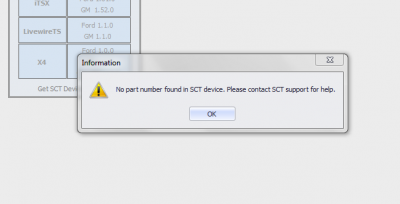

So, Since they're support sucks, does anyone have a solution for this?
I have livewire Gen II installed and when I plug my tuner in by USB cable, I get the following message "No part number found in SCT device. Please contact SCT support for help."
I then tried to update the firmware but when I try and use the automatic updater, it says "No part Number Found"
SCT does not have any firmware files available for download-does anyone have a newer X3 firmware file that I can try? This device has what I'm guessing is a pretty old one, 1.2.121 is the current firmware version on it.

What OS on the PC?
I don't think Gen II works with the x3 - I had to use Live Link as I recall.
Also the. X3 firmware is old as the device is out of date in SCTs line up.

The thread below says if the Firmware is too old, then it won't work with the updater (Gets the part number error). SCT will have to remote in to fix it. The thread is from 2013, and has a different phone number. Not sure if it still works.
http://www.powerstroke.org/forum/general-6-0l-discussion/437377-sct-x3-tuner-update-issue.html
Also, you may want to check if "both" drivers are having issues (yellow exclamation near the X3 in device manager). Apparently these devices have a "bootloader/firmware" and "normal" mode, and each behave differently with the drivers.:
http://www.svtperformance.com/forum...45-SCT-SF3-X3-handheld-firmware-update-issues
According to SCT's site, the XP's should be able to use the auto update feature in the software, but as the first link shows, if the firmware is too old, it may not communicate with the software. Last I saw was they were up to 1.2.155 on the firmware (there were quite a few in between as well).
