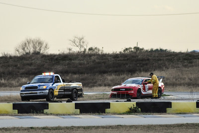

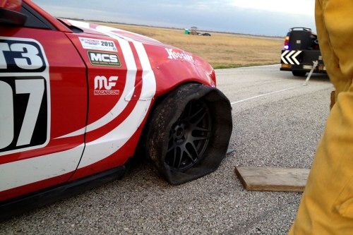

My wife and I often co-drove our TT3 Mustang on the same race weekends and one time at MSR-Houston she got into a tank slapper and clipped a curb with the front wheel sideways at speed.
Bent the wheel, bent the tie rod, and BENT the factory control arm. But it didn't break. We secured the TT3 win in an earlier session on that Saturday of a 2 day NASA weekend... if we had aftermarket control arms we would have dragged it onto a trailer, because that bish woulda BROKE.
You better believe I swapped front wheels, re-set the toe, and raced it on Sunday! That RF corner had positive camber, but I still won the TT3 class that Sunday. Wasn't ideal, but it also wasn't broken, like any aftermarket arm would have been. The OEM steel front LCA is a TANK!

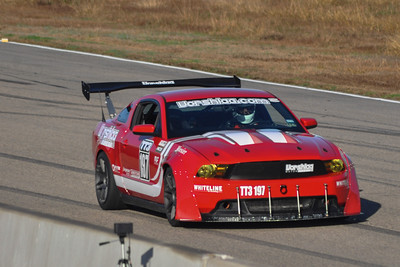

As for the Whiteline front LCA bushing setup, we recently noted that the Boss 302S bushings were TRASHED on this S197 race car.
We're swapping to the Whiteline bushing kit as soon as it arrives (next week). I've had such great luck with ALL of their S197 products.
This car also has their "dual durometer" adjustable upper rear control arm (KTA205), too. And yes, its a race car. And yes, that is just fine. One less spherical bearing to have to be replaced 1-2 times per season. ;)
Stay away from aftermarket arms and try the Whiteline LCA bushing kit.
