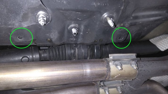

Does somebody know for what these empty clips and studs are for? They are also on the other side.

Loon at RocknRods pics. He has a super clean untouched undercarriage.
Looks like where a heat shield goes?
Oh, a heat shield to protect the driveshaft support bearing, makes sense. And the beancounter discarded it.
