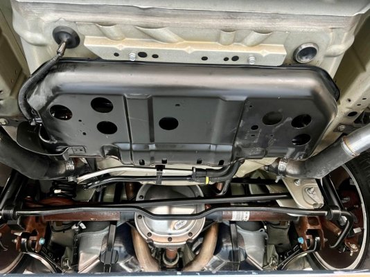

Well I got both sides out and the panhard bar installed. Tomorrow I go get the spring compressor rented at O'reilly's. Still sick but I can't let that stop me so I went slow.

Panhard in. Spring on driver side cut and installed. Looked at the spring again and how much I cut off, was not quite 1/6 of it. Really shouldn't do this right now. :headscratch:

Geez, was this thing kept in a vault? Looks brand new for pity's sake. I've never seen anything so clean for it's age.

I plan on removing the rear end this year and dry-ice blast it to clean metal. Replace the stickers and marks then clear coat the axles with KBS Diamond clear. Of course the center section black . . .

Don't know what you paid for it but looks like it was worth every penny. :snoopy
