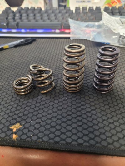

Pic of springs, on left is broken spring, in middle is spring pulled out of head and right is the springs ordered. Second pic is springs ordered in there packaging.

The two intact strings are effectively the same length. I do not believe the broken spring is a stock Ford spring. I think it has too many coils. As far as the cams go, the stock Ford cams are a hollow steel shaft with the lobs pressed on. Aftermarket cams are machined from a solid shaft so they are one piece.

Ok one new OEM Ford spring, one new melling but where is one old not broken spring pulled from your cylinder head? You say new ones are shorter but how do you know that?
Loriannes keeper
May 22, 2026
8
SC
I measured, the spring from the engine in the middle is 1 tenth of inch longer than the ordered spring. That's more than a 1/8th.
