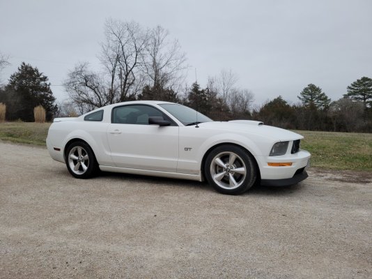

I have the Ford P springs. On stock 18" wheels.20230226_173537.jpg20230226_173551.jpgDon't forget the Ford Performance bumpers.

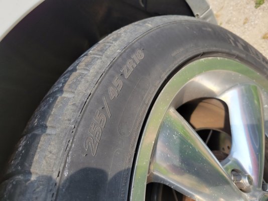

Definitely get the adjustable panhard bar. I think there was a visible 3/8" shift to one side. That was with the 235 tires. The 255s add another 5/16"-3/8" to each side of the tire. So that would emphasize the shift.

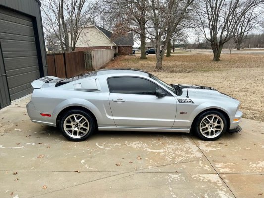

This is what my car looks like... Daughter is driving... LOL
