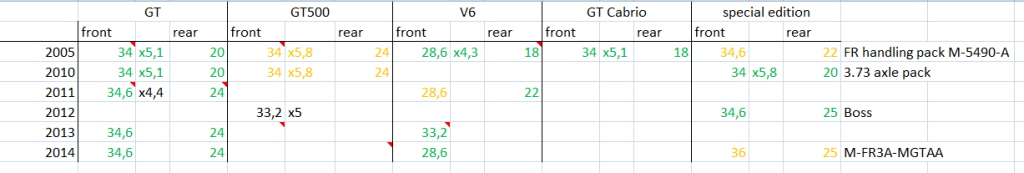

GriffX I just checked my takeoff 06' GT convertible F/R bars and exactly as your matrix 34MM/18MM
My 05' GT are in the storage, will mic them next time I go...

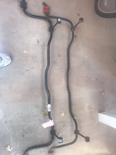

I took an overhead picture of this '13 base Boss 302 24mm OD rear sway bar against the '09 GT Premium 20 mm OD rear sway bar (I had installed the red higher durometer Ford 20 mm poly bushings kit prior this work trying to improve it's performance........) during replacement for visual comparison........ The Ford OEM black durometer rubber bushings in the '13 base Boss 302 unit made those Ford red polys seem soft when I tested this before installation.
There are 2 OEM rear sway bars for 11-14 S197's that are larger than this 24 mm OD unit...........a 25mm OD & a 26mm OD exists as well.
Any wonder as to why the later 11-14 S197's OEM suspensions perform better than the earlier 05-10 S197's?
Just because they look\appear to be the same design is very deceiving.
