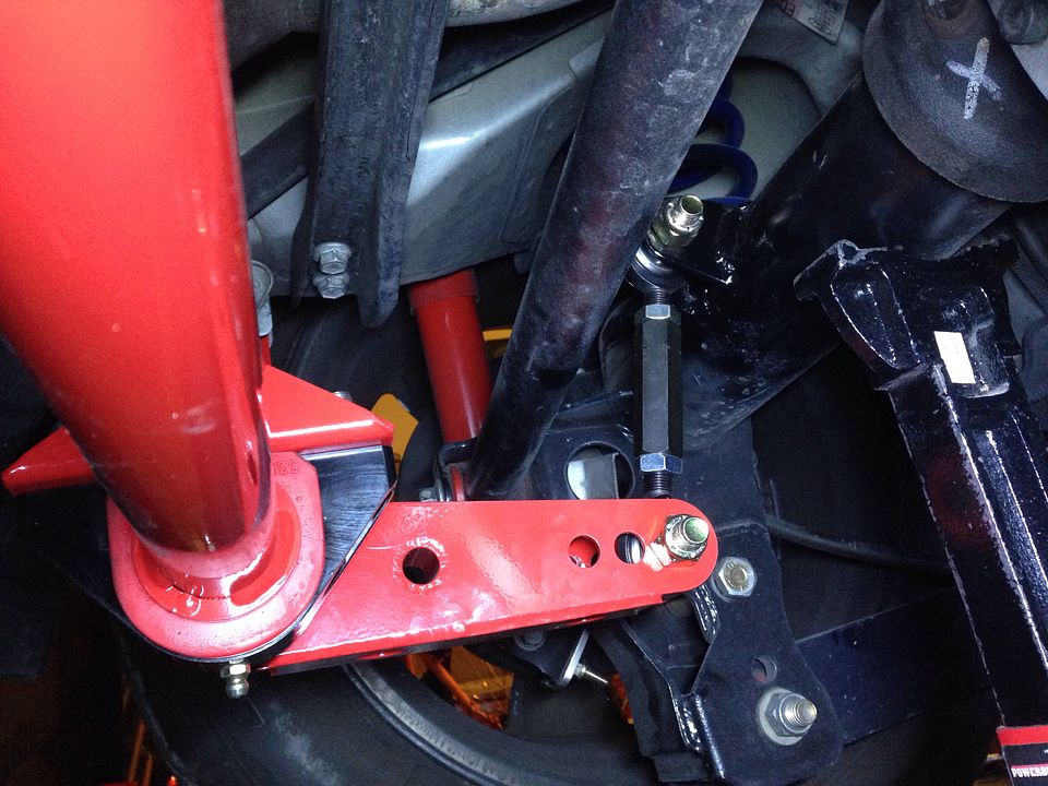

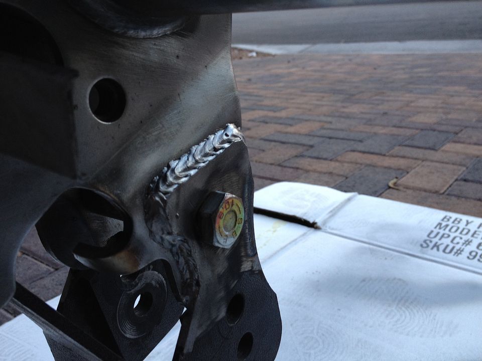

The upper diff bushing is easy peasy if you drop the rear end out of the car, literally 10x easier. Granted you don't have to remove the rear end to swap all those parts but its only a couple more steps and like 10 bolts at that point. You might as well. I had to pull mine to get some sway bar mounts welded on and had them weld up the tubes too, but it made the bushing swap a 10 minute job as opposed to trying to do it lying on your back. I had my relocation brackets welded in place as well.
