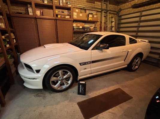

Hi Fellow Enthusiasts,
Here is my GT 2008 California Special, 119000 miles, way over here in Sydney Australia.
In front is the JXB Performance Driveshaft Carrier (Street Bushings).
FRD01AO-S
I very much like the idea of the item ‘tightening up’ my OEM 2-piece drive shaft. Though I don’t see many reviews on sites or YouTube vids re the item.
Can anyone out there share their experience with this item?

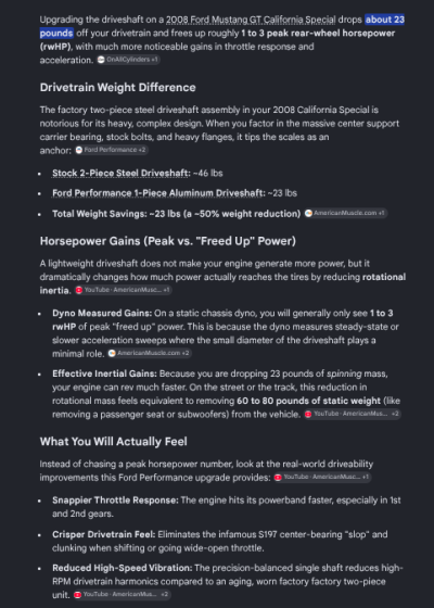

Very noticeable upgrade on these cars. Not cheap for those on a strict budget but the drive line response is quite noticeable and you have a much more bullet proof driveline. I have one in my car.
I know its AI so take it for what its worth but it has a few good points for those that absorb info.

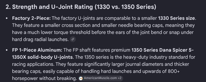

Also the U-joints are a lot stronger. 1350's are another nice bullet proof feature of the FP one piece.
