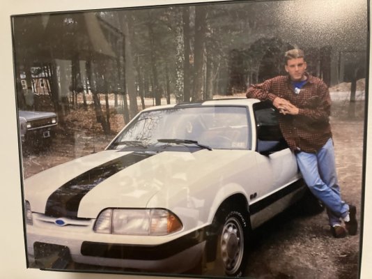

Let's see if the pics work. I'm including a pic of my last Mustang, an '87 LX 5.0 with a few goodies.
