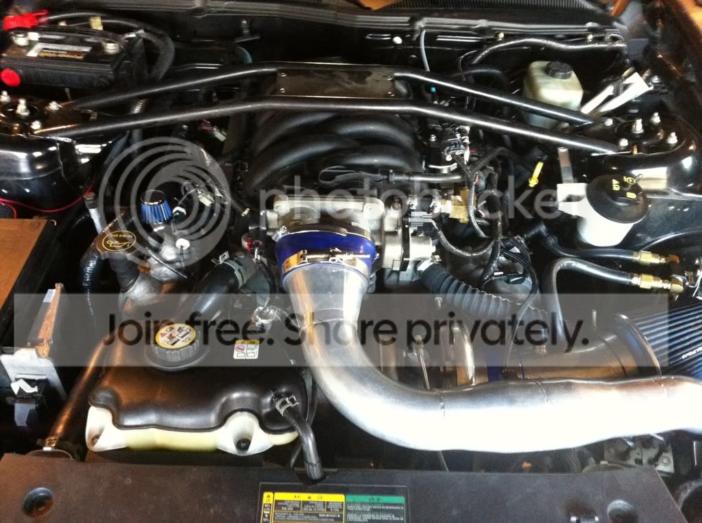

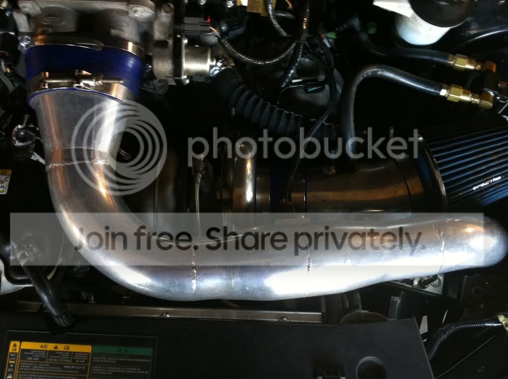

I'm happy with mine, though we did have to trim a little on both sides on the top corners:
Oh, and making a bracket to mount the coolant tank in the same spot is simple:
This cleared up SO MUCH room!

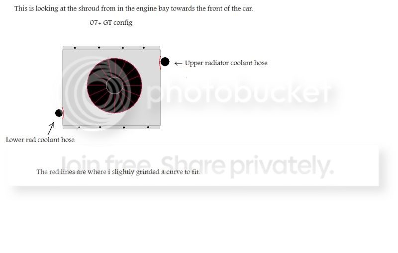

The trimming was very minor, it took me 30 seconds with a grinder to make it work. Here is a rough pic of the trimming. lol Windows paint ftw!
