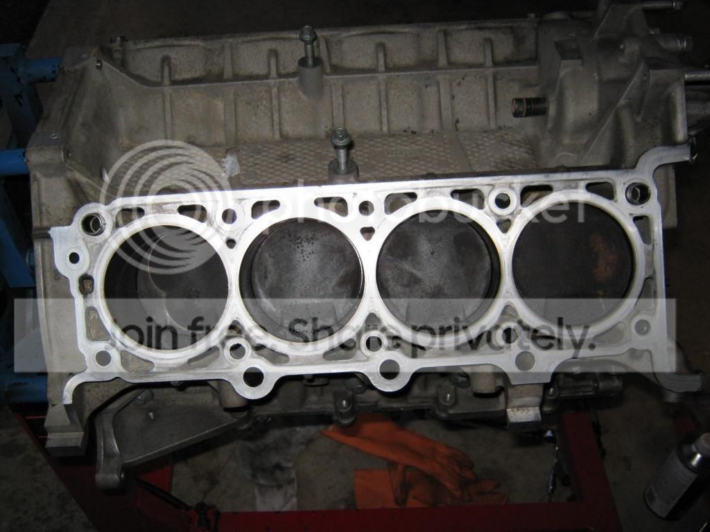

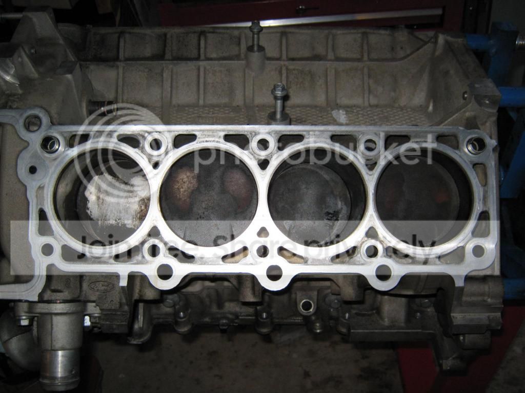

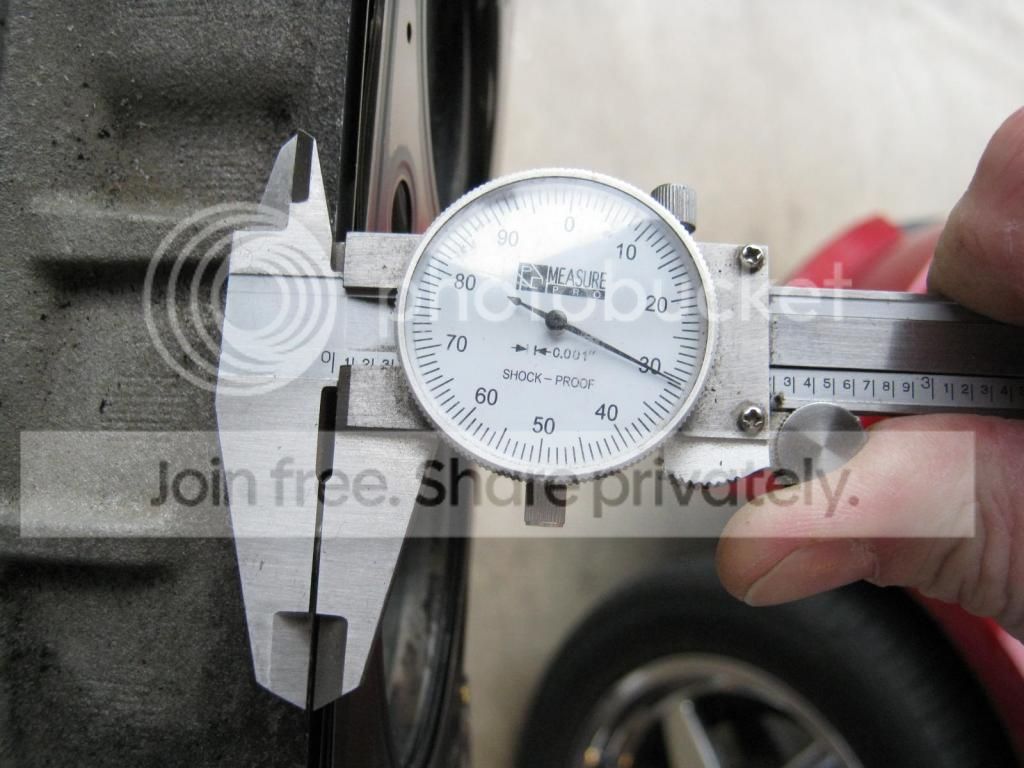

Today I cleaned up the decks. They cleaned up fairly nice. Notice the 25,000 mile ridge, I don't think it's too bad at all. I've already measured the end play and side rod clearances. All is good. So good that I'm not freshening up the bearings. It used no oil and the phasers always worked as commanded so oil flow was good to the top end.
Tomorrow the deck surface will be verified as flat. The two almost new 2009 heads that are going on it will be cleaned and straight edged. Then they are being bolted on and I'll have a nice long block on the stand. Compression will be 11:1 with the flat top Mahle pistons and stock combustion chambers. It's a little over 285 cubic inches because of the .030" overbore.

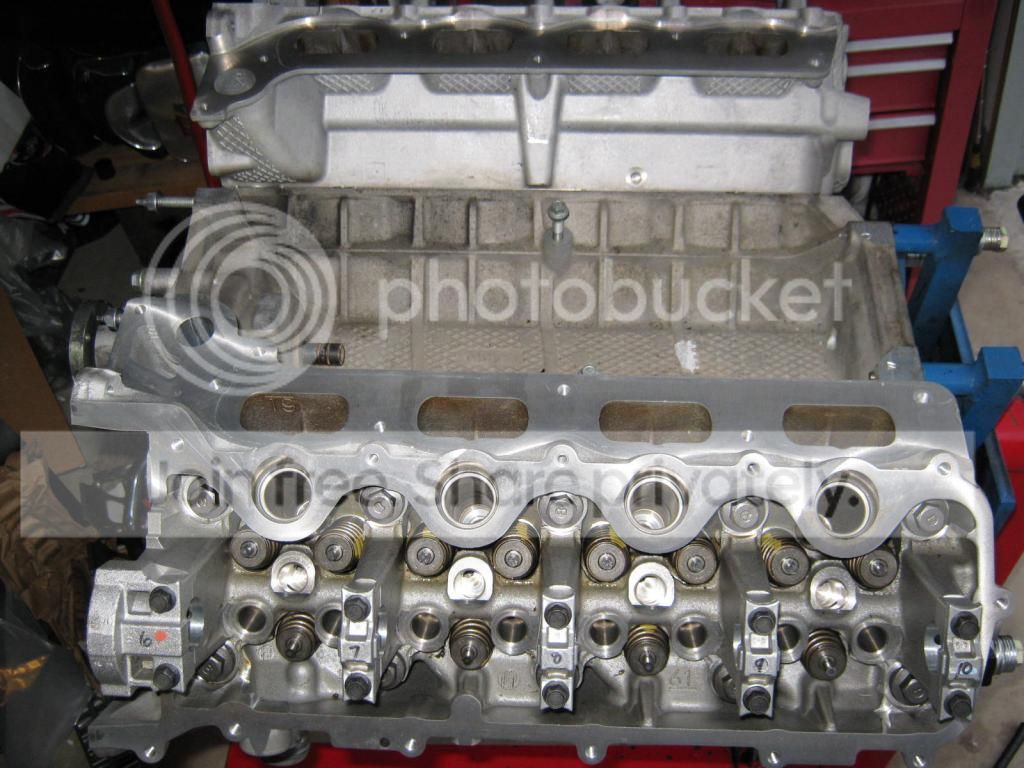

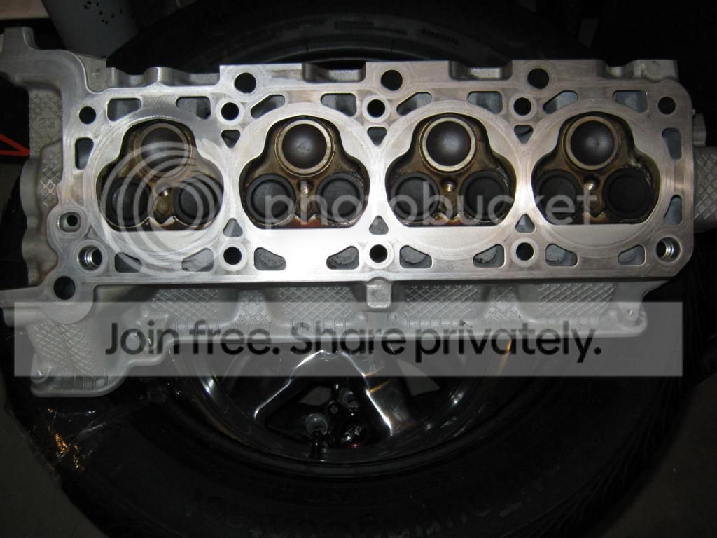

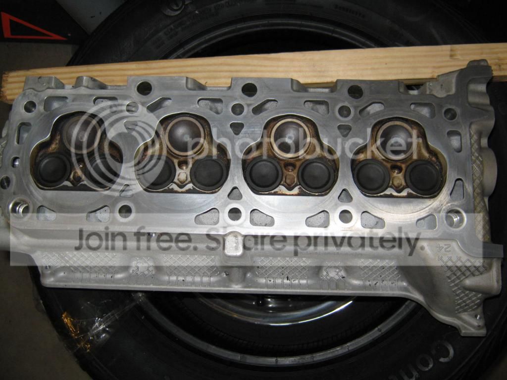

Put the heads on today. They passed the straight edge test for flatness as did the block decks. Cleaned everything up and bolted them on.
Cleaned heads:
FRPP head gaskets on. They measured .031" compressed. They are always that size for me.
Ready to be bolted down and all bolted down. 30 ft lbs, 90 degrees, and 90 degrees.
That's it. Instant long block. Compression calculates out to 11.27. The deck height is .003", bore 3.581, stroke is stock at 3.543, valve relief results in 1cc of piston volume and I'm using the 3v standard combustion chamber size of 50.3cc. Displacement is 285.47 cubic inches.

The reason this motor is .030 over is because the seller wasn't an honest person. When I received the block it had gouges in the cylinder walls that needed .030 to clean up. They also cleaned everything with a power tool. That required decking the block which resulted in the .003" deck height. I also assemble the covers with rtv and the gasket because of the aforementioned power tool.
