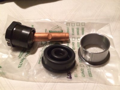

Ok- they're in. No issues with installation, other than my own confusion on how they connect to the steering knuckle. I reused the fomoco pinch bolt.

Are you planning on circumferentially welding in the sleeve?
Fuerte
Sep 27, 2011
694
Is that needed or does the sleeve fit inside the hole for the old ball joint and the base is a bit oversized so it is held in place?

The base of the sleeve should hold it in place, but I'll have it welded in.

Alignment is done. Performance Chassis had no problems or concerns with the Steeda Bumpsteer kit and BMR ball joints. No issues with fit on the 18x10 D Force wheels either. I guess all that's left is to check ball joints whenever I jack up the front end. I'll keep you guys posted. Thanks to Kelly at BMR!
Looks like there will be a set of X11's going up on Ebay. I'd like to say I made $20 off this deal, but the $100 alignment took care of that!
