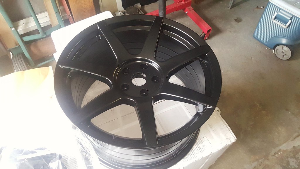

GT350R looking wheel
MELLOWYELLOW06
Apr 6, 2010
1,452
Los Angeles
It was done as mirrored image since the other side are red. Thought it would look cool as one uniform color.
Same wheel though!

Did you have to do anything special for the S197 to get it to fit properly? Also, did you have a weight on the 19x10's?
Pentalab
Mar 5, 2013
5,216
1,104
Those offsets will fit the early s197s fine with a little camber. WOnt take much.
More than likely fit easily within the -1.5 ford says is in spec.
I had a 20x10.5 +33 that BARELY stuck out up front.
How the heck did you get that to work? A 18 x 9 +30 is barely under the fender..with -1 deg camber. Same deal with a 18 x 10 +42.
On paper, a 20 x 10.5 should have a +48 ET. With just a +33 et, it would be sticking out 15mm or aprx .6"

They fit on the S197, 2010-2014 with no problems
Here is the 19" version with 345/30/19 out back and 305/35/19 up front we slapped on for fun and no rubbing with the Eibach Pro kit
