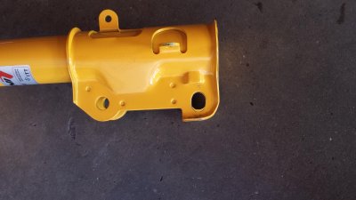

You can fix 1/2 the camber problem for free. See the attached image of the slotted bottom strut hole on my Konis.
I'm running those slots with the full sized cross-bolts and camber plates.
After doing this, you have to fix the toe.
I would strongly suggest making an insert to fill the void in the oval or weld thick washers to the outside of the strut once you get the camber you are happy with.

Or a thick eccentric washer tacked to the bolt head and a couple of "fences" tacked to the strut ear, which would allow adjustability afterward.
Norm
That is a great idea - I wish I thought of that when I did mine

I can't claim all the credit (although I did do something vaguely similar on the Mazda 626 that I used to autocross).
My wife's Subie has taken a similar approach as their OE solution to front camber adjustment, even incorporating a scale of sorts where one line = some specific amount of change.
Peter Basica has taken the eccentric washer approach to the aftermarket for caster adjustment on the 5th gen Camaros. Obviously the eccentric washer on the nut side must be left loose (looks like it's there to eliminate all possible bending from the bolt).

Thanks Norm - I will remember this if I ever have to do something similar again
