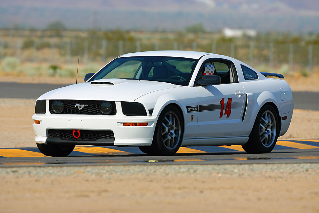

On another being said, the car in the photo was a decent compromise, just a little rougher-riding than stock, with FRPP "P" springs, KONI Sports, Steeda front adjustable bar, the H&R 26mm rear bar, and 285-40 tires on GT500 9.5x18-inch rims. See how the right front wheel is not carrying much weight in this 80mph corner at Chuckwalla Valley Raceway.
