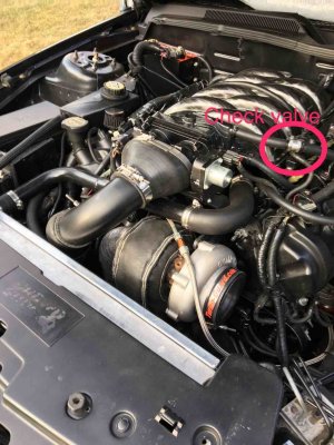

I just cut the pieces out and put a plate over the top of it screwed in place sealed with rtv I think. I pull vacuum on that side via intake and modded a coyote catch can in the chain to pull fumes and any blow by. The other side I have normal breather filter.

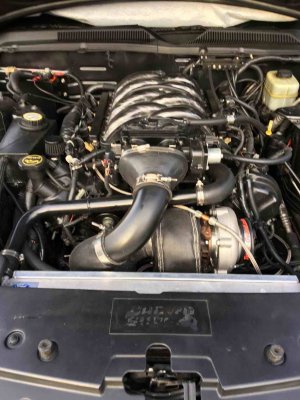

Crappy picture sorry. I was pulling vacuum on both sides so I have another line going there but i plugged it off and need to rework just been lazy.
I don't get any fumes or oil in the can and I have like $20 for it lol

One way check valve that doesn't leak boost through only draws vacuum to the can. I will keep mine this way do yours however you like. I wanted a cheap catch can and stock pcv valve leaks so this was my solution. Works fine for me.
Passengers side has no pcv you can just draw via breather
Didn't know you had another pcv in line so that takes care of being under boost. So under vacuum the intake draws air through the check valve. So where does that air come from? It enters through the breather on the passenger side, right? That air drawn through the crankcase and into your intake is unmetered. The engine computer doesn't know it's there because it's unmetered.

The oem drew fresh from after the maf so your theory is correct. The amount must be minimal otherwise the afr would be wack. This was done a while back when I had what I believed to be a blow by issue(oil leak front cover and pan) so I could probably just go back to breather on drivers and cap the intake port and remove the can. Been boosting heavy for 5000 miles with no issues but probably worth plugging off and venting now to be safe

Yeah, it was only probably drawing any air at low load and rpm so your motor is leaning out anyways. No harm no foul. Me, I would just ditch the can anyways. I don't get much if any drippage running 3 breathers. I do change them out every once in a while though. They will get gunked up from the inside over time.
