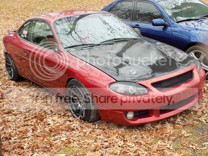

Hey guys! Name is Jake (in case you couldn't tell by the username). I moved to Germany in april 2016 shortly after buying my first mustang, a bone stock 2005 GT premium with only 35k miles, garage kept, only driven during warm months... even has the tires and brakes that came from factory.
[PHOTOB][PHOTOB]
I've loved mustangs my whole life, but (somewhat controversially) never was a huge fan of drag racing. I don't see too much joy in going fast in a straight line for 10 seconds at a time. Road racing has always been more of a rush for me and requires more skill, dedication, and hard work to perfect. Therefore, my mustang will be built for a road corse rather than a straight line. I've been racing go-karts since a young age, and built my first car for autocross. it was a 2003 ford ZX2, and has about $9k invested in mods. The car was a great experience, taught me a lot about customizing cars, working with a goal in mind, and helped me adopt driving techniques to shave down my lap times. It's currently in storage back in the states, will be getting a turbo build once I move back.
[PHOTOB][/PHOTOB]
An 8 minute Nurburgring lap time certainly is attainable. I have put down a 9:47, but my fastest recorded run is a 10:15 on my first ever lap. That being said, there are a few hurdles to overcome:
∙Needs to somewhat retain daily driveability. I say somewhat because my previous car was an EXTREMELY difficult daily. 2200 lb car + 10K coilovers + stripped interior - no A/C or PS = terrible daily driver, so I'm used to some pretty rough stuff
∙Needs to follow a budget. As a 20 year old with a low-ish income, gotta make sure I have money to pay the bills. Therefore, $2000 coilovers, $10,000 engine builds, etc. are out the window
∙reversibility. I plan on selling the car within the next couple years, and I plan on returning the car to stock before I sell it (yes, that means everything you see go on the car in this thread will be in another part-out thread in the future). therefore, everything I do have to have the ability to be reversed, or has to be subtle... as in no cutting vents into the hood, no crazy aero parts, and no big jobs that will result in an overly time-consiming tear-down.
